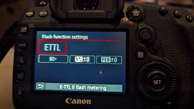

Any older Canon EX series speedlite will work. You’ll have to buy used though. What are your needs for flash. Some older speedlites would be the 220EX, 430EX II & 600EX II-RT. Older speedlites released prior to 2007 or released before the original 270EX, 430EX II & 580EX II. Are NOT COMPATIBLE with the in camera flash menu. The camera will report incompatible flash or flash powered off. This is normal and the flash is functioning correctly. Older speedlites were not designed to be controlled by the camera menu. Settings can be changed on the flash unit itself. The flash functions menu will display settings grayed out or missing. This is normal and the speedlite is functioning correctly. Avoid older E, EZ, TL & G series flashes. Those flashes are designed for film cameras and utilize a different and INCOMPATIBLE flash system. Example speedlite models would be 90EX, 220EX, 270EX, 270EX II, 320EX, 380EX, 420EX, 430EX, 430EX II, 430EX III/ III-RT, 470EX-AI, 550EX, 580EX, 580EX II, 600EX/-RT, 600EX II-RT, EL-100, EL-1 & EL-1 Version II. Entry level flashes are the 200EX series & EL-100 ie 220EX. Midrange flashes are the 400EX series flashes ie 430EX II. Professional flashes are the 500EX, 600EX & EL-1 flash units ie 580EX.
Example picture of what camera displays with an older speedlites not coming with the camera menu. Example speedlite used 550EX.

I’ll simply it for you. Speedlites released before 2007. 380EX (1995-2009), 220EX, (1996-2009), 550EX (1998-2004), 420EX (2000-2005), 580EX (Classic, 2004-2007), 430EX (Classic, 2005-2008). Or you could also Google it too. You’ll be very limited with an entry level speedlite. They do not allow manual adjustments or recharge quickly enough if high power levels are needed. They also lack on flash controls. Newer entry level speedlites are very dependent on the camera menu to change settings. The old 220EX also lacks on flash controls but it doesn’t rely on the camera menu to control it. That speedlite along with the 380EX & 420EX retain partial compatibility to set 1st/ 2nd curtain sync and Flash Exposure Compensation (FEC). Since these older flashes lack a physical button or switch to set that function. They only have a switch to enable and disable high speed sync (HSS). When set to HSS it overrides the camera menu’s ability to set 1st or 2nd curtain sync. With the camera set to Auto you cannot change any flash settings. The speedlite’s on flash controls are completely disabled. All the speedlites I listed are compatible with your camera since you didn’t know which were. Some speedlites were in production for years before being replaced. The 220EX was in production from 1996-2009 (13 years) before being replaced by the original 270EX in 2009. So it was never designed with in camera flash menu compatibility in mind aside from setting 2nd curtain sync. Originally there was a custom function in older film cameras and DSLRs to set that. But in 2007 it was moved into the in camera flash menu which is present in all cameras released from there on. When that speedlite was released only film cameras were available. Canon’s first DSLR the (EOS D30) was released in the year 2000. So newer features in newer cameras won’t magically work with older speedlites that never supported to begin with. Except for E-TTL II being supported. This was a change in the camera body not the speedlite itself. So all speedlites support it. Canon originally released the E-TTL flash system in 1995 (30 years ago). Then updated it in 2004 for better flash metering. This was done in the camera body. So there isn’t such thing as an E-TTL II compatible flash from Canon. All of them support both the original E-TTL flash system and the updated E-TTL II flash system released in 2004. Auto flash exposure is controlled by the camera not the flash. I recommend sticking with a midrange flash for beginners. They usually have enough power and support future off camera use if needed later on. Unless off camera flash work is not needed. A boost in power is very helpful outdoors in bright light and so is fast recharging.
