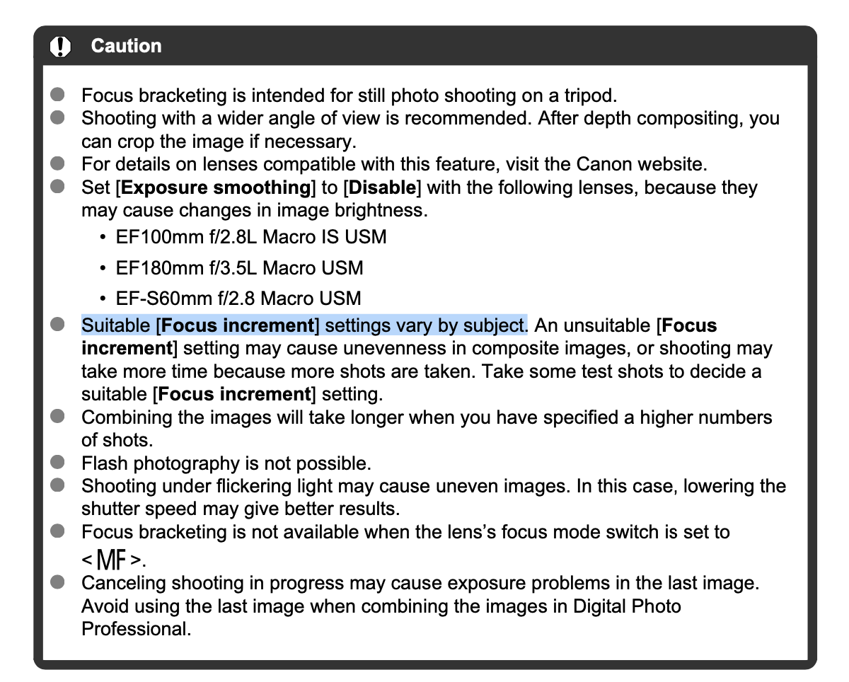

This is from the R5 User Guide.  It requires some trial and error to get it "right".
