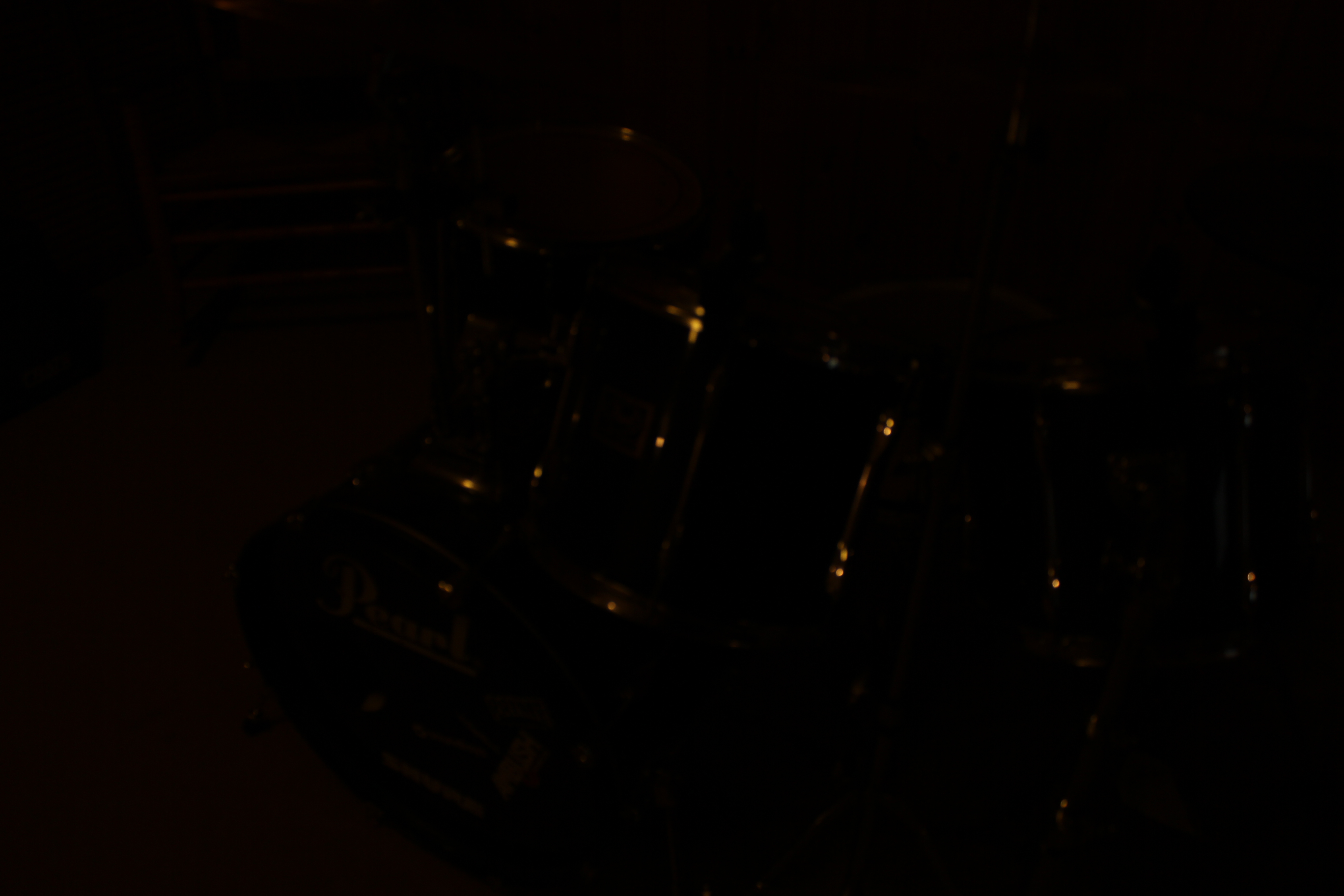

Thanks for the reply! When in manual mode for photos, I get the same results as for video. Extremely dim photos.IMG_0903[1].JPG

Re: EOS T2i Video Mode Issue
Is this what you get when the exposure meter in the viewfinder is at the center point?

Yes. The exposure meter is at the center point.
What happens if you select P mode?

Normal photos with iso 100
