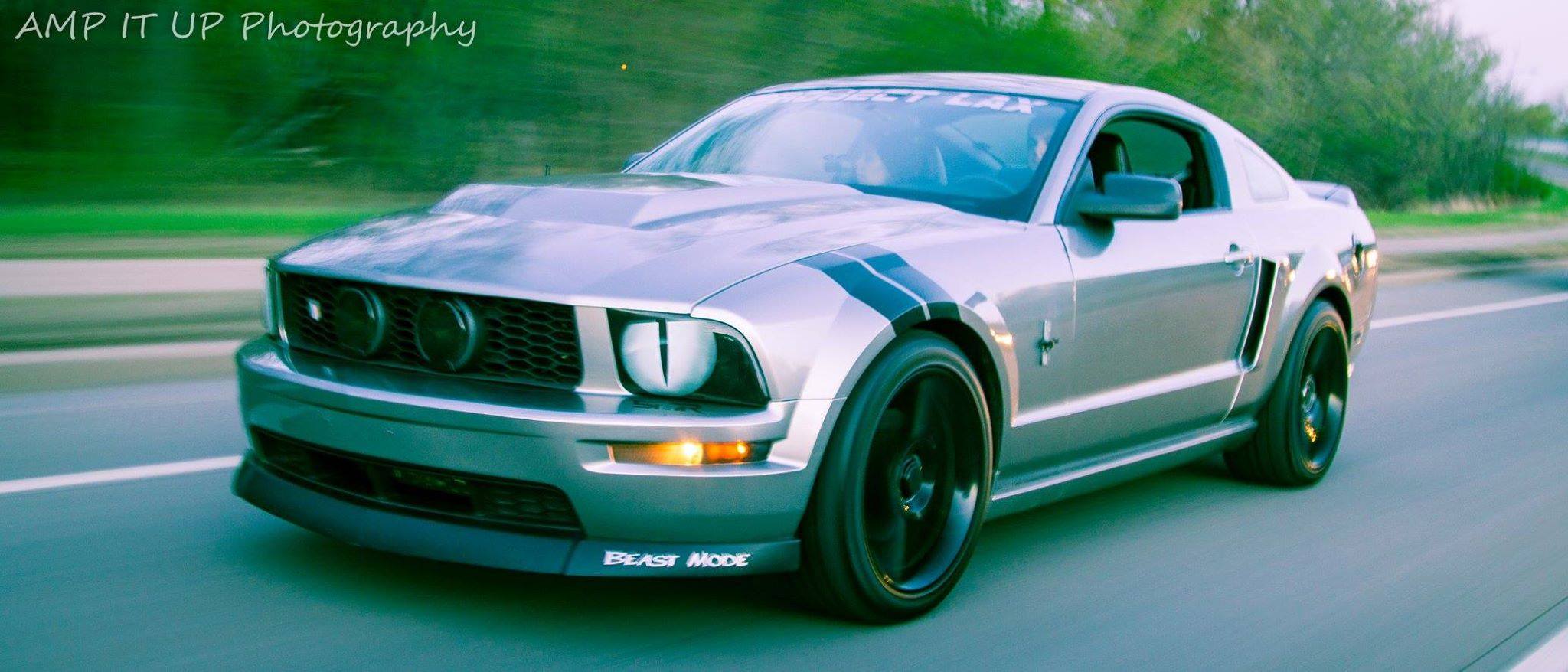

I used all the same settings on this photo in the link...I have done it a lot and yes there are room for improvements...I just have never seen this happen on these settings and did everything I could think of to change it. If you are unable to follow the link I figured to add a few photos just in case11052475_1577560209164123_6866058506282406546_o.jpg

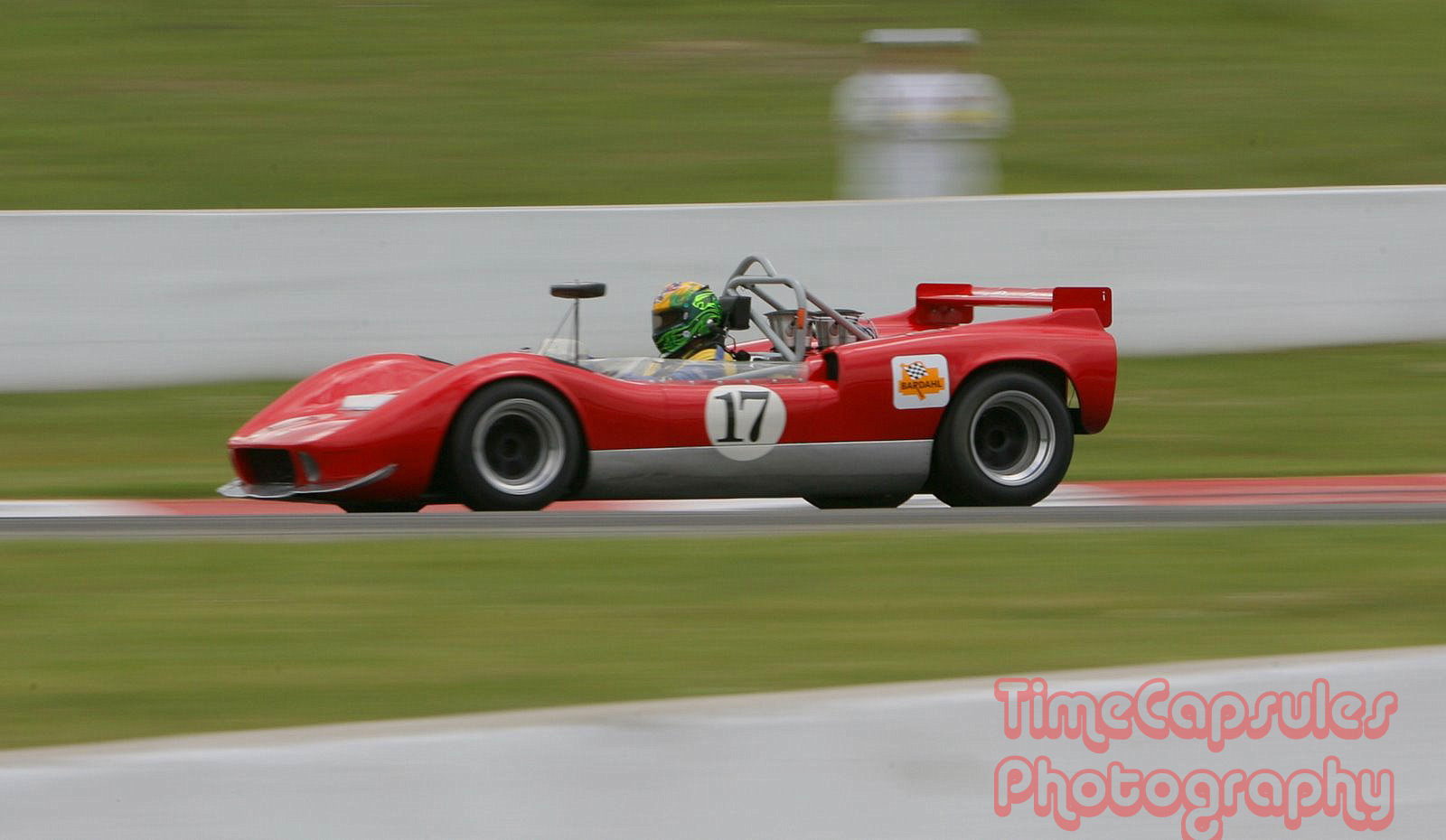

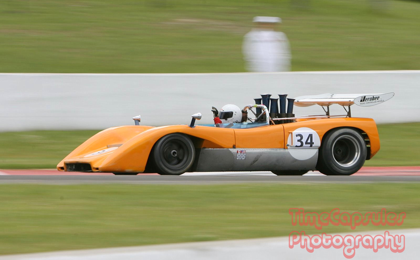

It's not what setting you've used before but what settings fit the current situation. Everything depends on the light at the moment you take the shot. Do you understand how to use the built in light meter? If not read your manual until you do because you MUST rely on it in Manual. Here are 2 shots I took many years ago along with the settings which tell me yours won't work.
ISO is 100. Shutter speed is 1/100, F stop is f10.0

This is at ISO 100, shutter speed 1/60 seconds and the F stop is f18.0 & it's overcast.
Which means there is absolutely no way I could have shot either at 1/30 sec @ f2.8 without a very dark neutral density filter.

I was partly cloudy and I did try to adjust the aperture to 4.0 I played with it for a while I am just not sure why it was doing it on so many different settings like M, AV, TV, and P. 11088872_1577560205830790_1294450014276267288_o.jpg
this was at a different ISO and i was pretty sure that what it was at 1st but it just didnt want to take anything like this. I was just white several times even after adjustments. Not sure if its because I heavily use the camera and just need to replace it or if I need to update the software or something.
