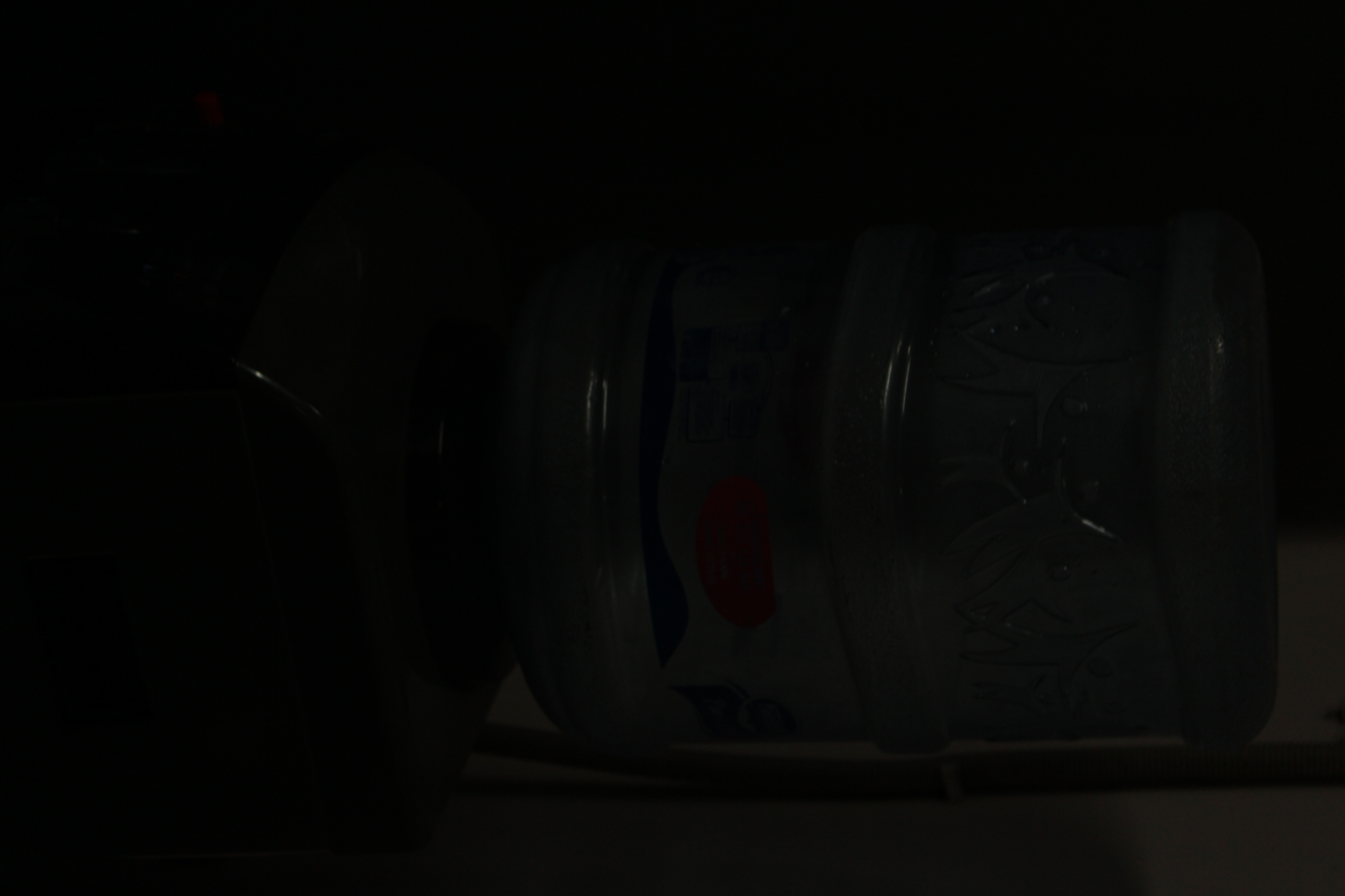

using canon 700d dslr, and after every 3 to 4 shots, it gives black images

Were you shooting rapid sequences with flash enabled? Maybe the flash was starting to overheat. Most modern flash units will shut themselves down to cool before irreparable damage occurs.

@RobertTheFat wrote:Were you shooting rapid sequences with flash enabled? Maybe the flash was starting to overheat. Most modern flash units will shut themselves down to cool before irreparable damage occurs.
This is the issue i am facing ri8 now. please asist me to resolve this .

i am shooting it on single shooting mode

@ahsankhan95 wrote:i am shooting it on single shooting mode
There are hints of an image in what you posted. It just appears to be massively underexposed. So I'll stick with my previous guess. The fact that you're using single shooting mode is irrelevant. You can push the button fast enough to overheat the flash if it's firing at full power. And it probably is, since no other light source appears to be active.

Or you didn't allow enough recovery time. Full discharge takes time to recharge whether it is hot ot not.
This is a tiny flash and not designed to fill a big area.

Adding an external flash like the 320EX is an option to correct the issue.
