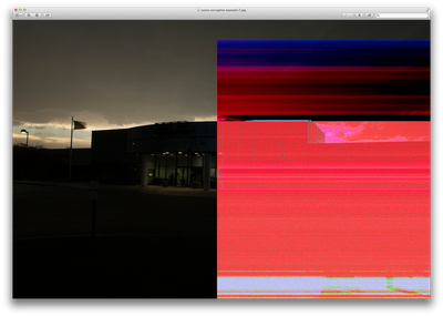

The shots above are a frame pulled from video and photo shot on my Canon MarkIII, respectively, during a shoot the other week in Omaha, NE. Every once in awhile in some clips, perhaps every minute or so, a pixelated corrupt frame will appear as seen above. As well, during a couple of my timelapses a number of corrupt frames would manifest, as seen in the lower image.
Has anyone else experienced something like this? I found this prognosis in another thread:
"it can also be an early symptom that the read-write circuit is starting to fail -- sometimes a capacitor or transistor works fine but when hot (lots of pictures over time or camera on a long time) starts to leak and sends out abnormal signals. If that's the case it usually gets worse over time. It can also just be external interference: a strong radio, electronic, or magnetic signal interfering with the camera's electronics. I've seen someone whose entire shoot turned out like that because he'd set up very near a large power transformer"

I'm inclined to think that you wouldn't experience read/write circuit failure simulaneously on the MkII whatever and the MkIII whatever. Cameras tend to follow their own adgenda and rarely conspire against the photographer so mischeeviously.
Aside from that conclusion, I'd look for a similar condition. You buy and use the same memory card(s) in both cameras. You live in a hostile environment or work in a hostile environment. (Hey, it's a fair question! Ha Ha.) You're like me and tend to drop your dearest posessions. 😞 Your memory cards are not rated for the data you're recording and you're overrunning the buffer.
