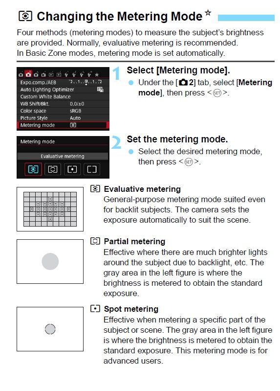

In the little information box, across from the camera model, it shows a little WB icon. I think that is White Balance, and it might indicate a Cloudy White Balance. Next to it is a little black dot, and I suspect that, as others have suggested, you have been in Spot Metering.
If you have been using a Program Shooting Mode, and Spot Metering, your camera is going to set an exposure almost instantaneously at whatever that center point is aimed at.
As others have suggested, you might try putting your camera in Evaluative Metering. This will meter off your whole frame, and not just one tiny area.

Thank you all for your input! Evaluative metering saved the day. (It's always like "duh!" after you find out the solution!)

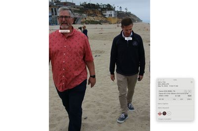

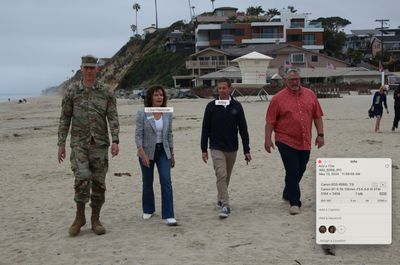

While I'm doing my research to answer your suggestions, here are a couple of recent examples of the exposure variations, both variations within one second of each other. Photo info is included.

My first reaction, looking at these images is that I am confused why you are using what you describe as a 'spray and prey' technique, which is not a great technique. It is clear that of the images you shared, some are in focus and some not, and it looks like your ISO is locked down to 100.
My first thought is that it is how the camera is being used that is the issue. You are using Canon EF-S 18-135 STM lens, which is quite a good lens, so unless the camera or lens have been damaged, it is more likely the setting or your technique.
I would be interested to know what exposure system the camera is set to - which is different from the focusing system. The default is Evaluative, which considers the whole visual area and averages out the exposure. Setting the camera to high speed frame rates is not necessarily the best for this kind of social photography. My feeling is you need to slow down and take more time to get a fewer, better images.
If you want multiple exposure, set the frame rate to a lower value and give the camera more time to do its exposure control.

Using this EV calculator:
https://www.omnicalculator.com/other/exposure
Your dark images have an EV of 14. "Good for taking photos on a bright day"
Your light images have an EV of 12-12.4 "EV ~12 is suitable for taking photos of the sunset, during sunset, and just before the sun sets." Which is a little lower than I would think for this shot.
What mode are you shooting in? The camera info shot shows Tv, but your shutter speed is varying in the sample images.
Either all the sand is fooling the camera - which used to be a big issue, or as Trevor suggests, it is your metering mode. If you are using the same mode as in the camera settings above you are using spot metering which would explain the discrepancy. Use Evaluative.
In this case, for the lower two images, the dark one is exposing on the sand between the subjects and for the light one it is exposing on the man's shirt.
