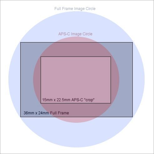

To expand a little on the Image Circle graphic Waddizzle posted you might read this basic article on angle of view:
https://www.thephotovideoguy.ca/blog/focal-length-and-angle-of-view
The simple explanation is that a smaller sensor size provides a narrower angle of view for any given focal length lens. That narrower angle of view is equivalent to a longer focal length lens. That equivalent focal length ratio is commonly called the "crop factor". That's why an iPhone [tiny image sensor] with a 4 mm lens can have the same angle of view as a full frame camera with a 26 mm lens. It has an "crop factor" of about 6.5.
