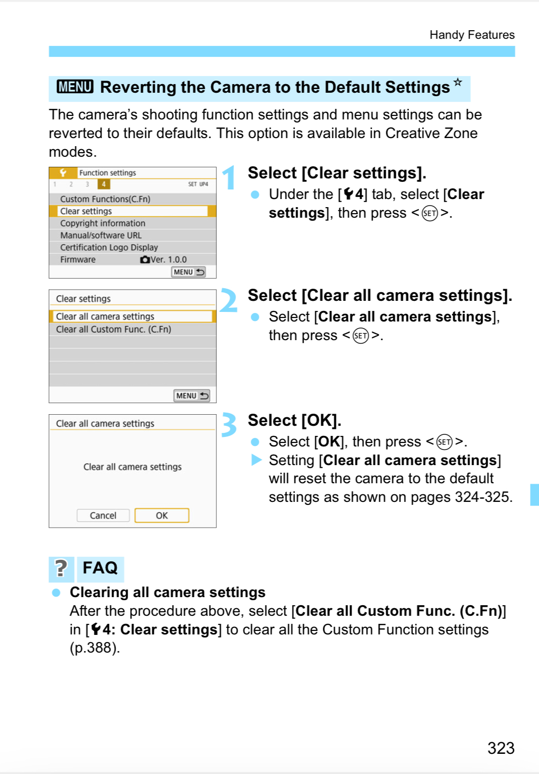

Try setting the camera to P mode on the shooting dial. Look in the Menus for the option to reset the camera back to factory defaults. Next, you want to clear out all Custom Functions.

@Grindolf wrote:
Hi so I have a really odd issue, my camera will focus fine, the flash works the green light to say it's focused comes on and my camera refuses to shoot...
However, I connect my camera to my phone via Bluetooth and tell it to shoot via my phone it will take a picture and save it to the memory card fine.
I know the button works because of I light press it out will autofocus, it just refuses to take a picture in Manual or Auto Focus.
Does anyone have any advice?

@Grindolf wrote:
Yeah my battery pack has a shutter release so I used the cable and it works perfectly, it works if I use live view and press the screen and it works if I use Bluetooth in my phone, it literally only doesn't work using the actually shutter button so I'm guessing it's damage to the button even though it will still focus using it. It's so odd
Remove the extra stuff, and test just the camera and a lens alone.
Is that a battery pack for the camera? The T7i does not normally use a battery pack, or battery grip. Canon did not desig it to use one,so they did not design a battery grip for it.
All of the third party grips use an external cable that connects to the shutter release input. When you're connected to the external shutter release, the onboard shutter button may be disabled.
