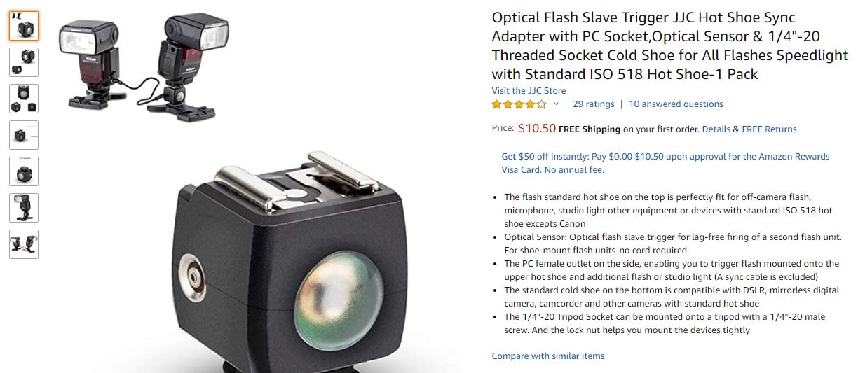

08-13-2020 03:35 PM - last edited on 08-13-2020 03:38 PM by Danny
Something like a simple optical slave trigger may work:
Put the wireless transmitter in its (the slave's) hot shoe, position it so it catches some of the T7's built-in flash, and it might provide the trigger voltage the transmitter needs to pop your strobes. No ETTL so you'll have to manually find a proper strobe output per ISO setting.
Clunky work-around, yes, but a $10 part might save your whole purchase. You sound pretty competent at troubleshooting and delving into your camera's control layers; if this can work you'll achieve it.
Sanity check... anyone with more knowledge than I think this makes sense?
[Link removed per forum guidelines. Screenshot added instead to facilitate discussion.]
08-13-2020 04:16 PM
Another option is to get an optical trigger and use the onboard flash to trigger it.
