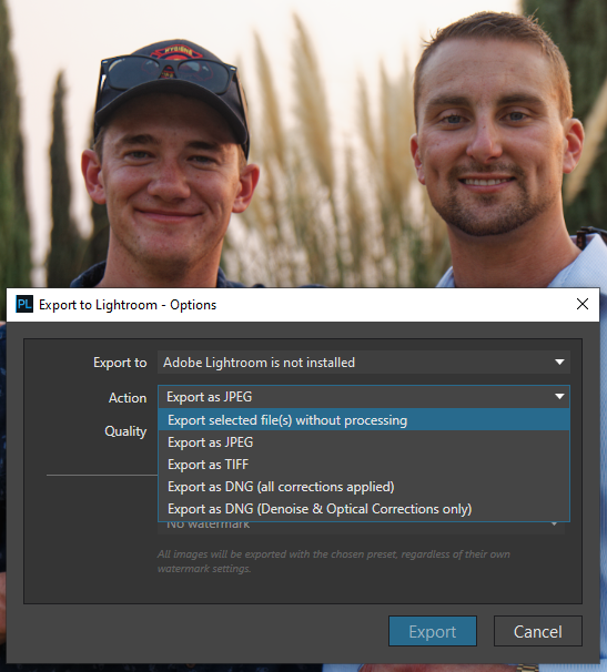

I got Photolab 4. It does a fantastic job with skin tones. Interestingly, I discovered the color rendering section and I get even better skin tones by rendering my image as if it were a Canon 1000D body. I get nice Kodak-looking skin tones. In Lightroom, the skin tones are more saturated and lean heavily to green/yellow. It's very frustrating. My workflow is going to have to be initial edits in DxO, then export to PS for portrait-specific editing that DxO mysteriously lacks entirely, like useful pleasing vignettes, dodging and burning, etc.
The problem I have at the moment is that I get an error when I try to export to Photoshop. I'm going to have to open a ticket with DxO, I guess. I also need to figure out photo library management. I'm used to doing it all in Lr.
