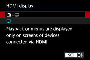

Ok so i got my micro HDMI cable.
- you can connect to a TV or a retroprojector with the HDMI out
- you can record internally and have live view on the external monitor by using the option screen only in HDMI display menu
- you can hide all the UI elements live focus included on the external monitor
- you can control your camera with the R6 II joysticks on HDMI monitor
- you can control your camera with camera connect in wifi mode while displaying live view on external monitor , you can have the focus UI visible on camera connect, but no UI at all on your monitor
- you can use the bluetooth remote control with camera connect
But
- you can't have monitor + R6 II screen activated at the same time if you want to record internally
- you can't have view assist on the external monitor
- you can't have view assist on camera connect app
so if you want to record internally and have video assist + focus control working while you shoot  and preview on an external monitor, i think you only have 2 options
