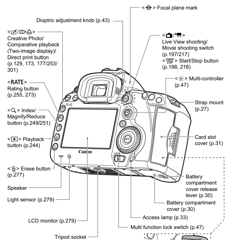

KAMDYN: please check the diagram on P20 of your manual, shown below: it identifies a button, just to the right of the viewfinder labelled Live View Shooting Switch.  That switches between live view using the LCD at the back, and the optical viewfinder.  Try checking that is not rotated, and if so rotate it back to vertical.
5dIII back.png  It identifies a button
cheers, TREVOR
In that case either mirror lockup is inadvertently set or your camera has a mechanical problem.
Go into the menu an reset all camera settings. See page 56 of your manual.
