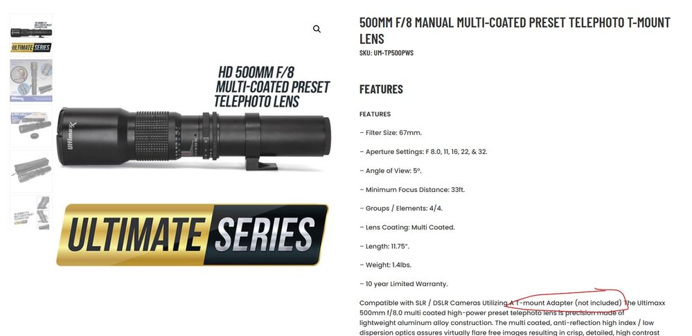

will a Ultimaxx High-Power 500mm (w/ Converter 1000mm) f/8 Manual Multi-Coated Preset Telephoto Lens fit a Canon EOS 2000D (Rebel T7) DSLR Camera w/Canon EF-S 18-55mm F/3.5-5.6 Zoom?

The info for that product says it needs a T-mount adapter, which is not supplied.
A T-mount adapter has a standardized mount on one side and a camera-specific mount on the other.
I can't speak to the optical quality you will get, but you will need to manually focus the lens.

Also focus confirmation will be dicey at F/8. With a converter, focus confirmation will be impossible at f/16.

The Ultimaxx shows up at $99 on Amazon along with a bunch of extra goodies. You get what you pay for. In my opinion even all the stuff that’s included isn’t worth 99 dollars.
I'm willing to bet you would get a higher quality image by cropping the image you get with your Canon lens than with that one. Any of the lenses recommended by Trevor would be good. The 150-600 is a beast of a lens. Hard to handhold. I can strongly endorse the Canon 70-300 USM II lens. The new AI tools like Topaz Photo AI are good tools for improving/upscaling digital images.
