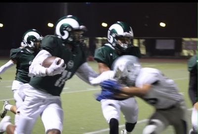

 the quality is gna be bad cause i’m doing this on my phone but the first one are the blurry ones and the last two are kinda what we’re going for

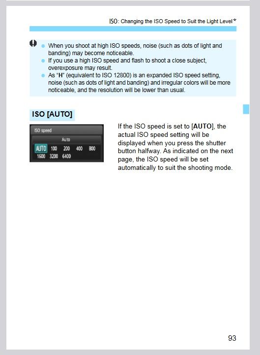

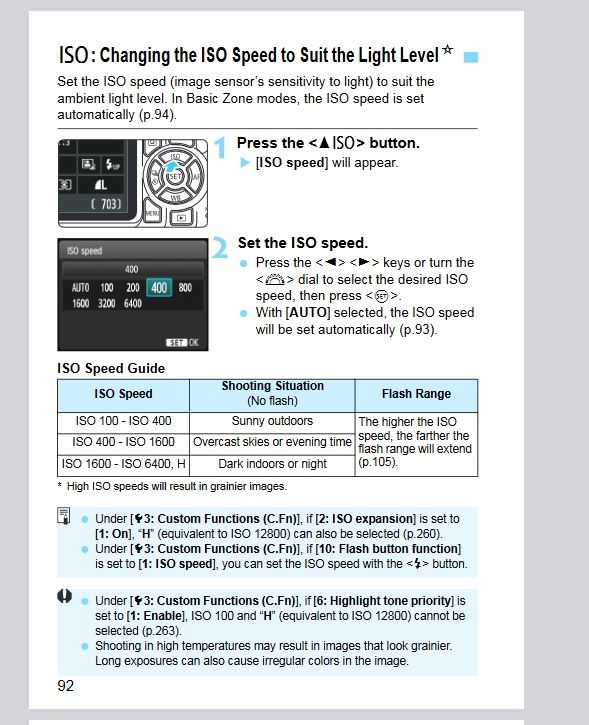

Here is how to set ISO:
Use either Auto, 1600 or 3200 and see if that helps. 3200 might be too noisy.
Hi ros4yy, welcome to the forum. Since you don't know much about cameras I would start with the manual. You should learn all of the controls and features of your cameras. Not knowing all of the controls and features of your camera. May cause settings to inadvertently changed. Canon provides free electronic copies of their product manual online. You can click the Link  here.

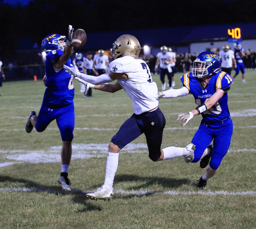

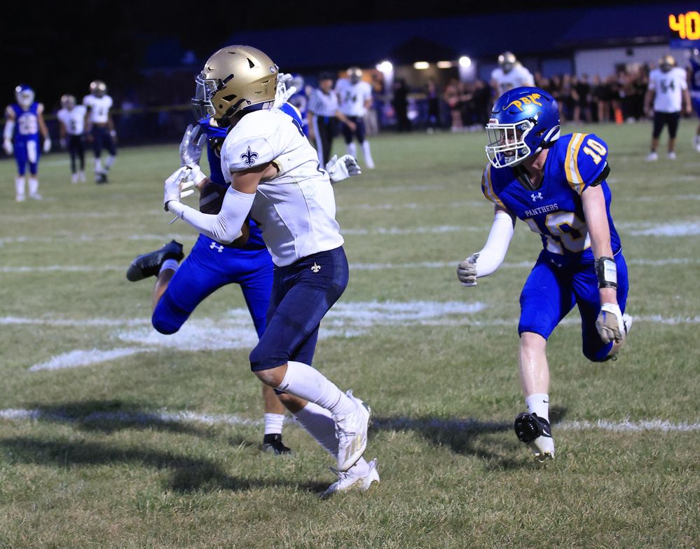

With sports, if your shutter speed is too slow then you will get nothing but blur.  I personally never fool with the "programmed" modes of the camera but instead put it in manual mode.  For football, I like to set shutter speed to 1/1,000 but that is probably too fast with the camera and lens you are using so set shutter speed to 1/500.  Then set the aperture wide open (lowest number) which I think is f5.6 if I understand your lens number correctly.  Set the ISO to auto.  I don't have a T7 but the manual for the camera will show you how to set it to manual and set the shutter, aperture, and ISO.  It isn't complex but it is so much easier for someone to show you in person so maybe check whether there is a journalism or art teacher at your high school or someone else who is likely to do photography and they can probably help you.
Also set your camera to servo AF (auto focus to follow action) and RAW (stores files as RAW instead of JPG because you can do a lot of noise reduction after you take the photo using RAW files).  Canon has free software to turn the RAW files into JPG images and it is easy to use, it is my primary photo editing software.
The other critical part of sports photography is LOCATION.  You need to be as close to the action as you can get without getting in the way of the officials so check with your school AD about field access and please be careful there because things happen very quickly on the sidelines.  I had to jump out of the way twice last night during the game to avoid tacklers who ended up well beyond the field marker line.
The following four photos were from the start of a scoring sequence last night, unfortunately ultimately a loss in overtime for the team I photograph.  I am using much more sophisticated gear than what you have but being in the right location had the most to do with capturing this reception in tight coverage.  Shot with Canon 1DX III and EF 70-200 f2.8 @ f2.8, 1/1000.
