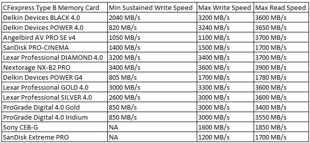

I can't post a link but here is a test sample of cards used in the R5 MkII

10-12-2025 10:33 AM
So a cards with a sustained write speed of 800 to 3000 makes no difference? They made no write speed improvements from the R5 to the R5 mk ii?

10-13-2025 09:14 AM
Usually cards with a sustained write speed over 800MB/s are faster than the camera can write(don't care about max, sustained is the important one), faster won't clear the buffer sooner.
One reason to buy faster ones is future proofing, who knows what next gen. camera's can do.
Another reason is the read speed, if using card readers to download to your computer.
