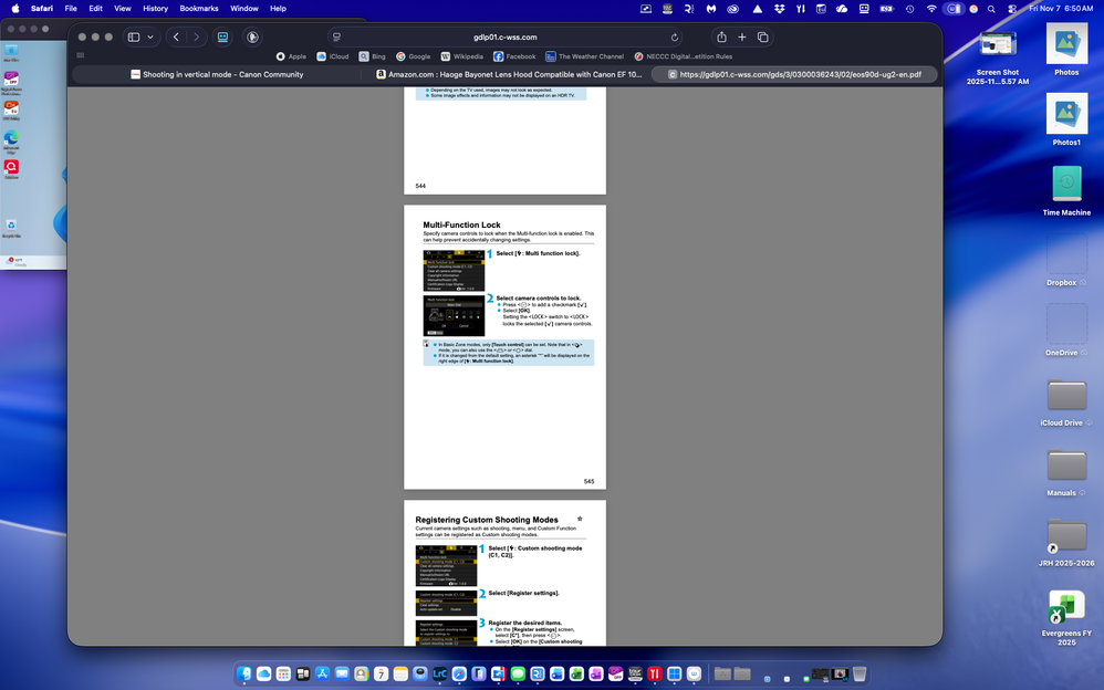

You can find the proper hood for any lens by checking the instruction manual for the lens on the Canon support site or searching Amazon for "lens hood for XXX"
Does your 90D have a "Lock" position for the OFF-ON switch?

jrhoffman75
I just checked - it does.

kvbarkley
If you are using a tripod, are you covering the viewfinder?
what does the exit say?
I have a lock switch, bottom right hand rear of the camera body,  but its not by the 'on - off' switch.
