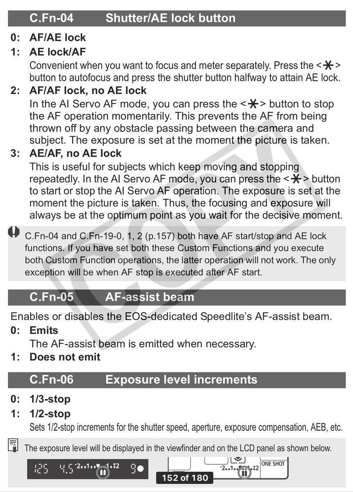

The EOS 5D has the option for 1/2 or 1/3 stop exposure increments. The previous owner must have changed it and it is easy to change it back.
Just go into the Custom Function menu as shown on page 152 of the user manual which you can download here: https://gdlp01.c-wss.com/gds/6/0900000316/01/EOS5DIM-EN.pdf
