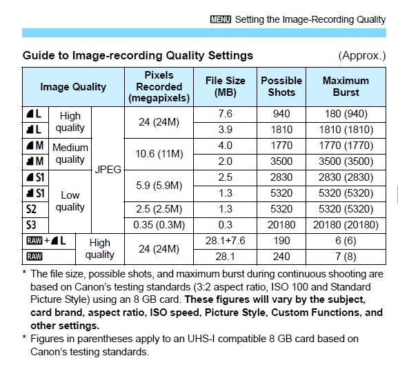

I was just curious.
If I take a 30 second exposure, and an exposure of 1/200th's of a second, is the 30 second exposure a larger file size; i.e. more bytes?
Steve Thomas
02-29-2024 05:29 PM
For Raw files, no.
For jpegs, the more noise the larger the file. So assuming that the 30 second exposure does not just blow out the whole image leaving it totally white, a longer exposure can result in a larger file.
During an idle moment, I actually looked at the number of files remaining as a function of ISO, and larger ISO's resulted in fewer files.
For my T6S:
I am not sure what card brand has to do with it, though. 8^)
