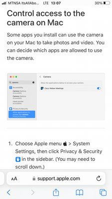

Also, please note the below option is not visible under camera privacy settings... no camera is showing

This option will only be visable when you use a camera that is being controlled by the system and is being seen as a camera. For example, by plugging the camera in by USB, and then using the EOS Webcam Utility. The EOS Webcam Utility is recognized as a camera, so your Mac will recognize it as a camera. Your streaming device may not be registered as a camera, but as a streaming device. Since the EOS M50 Mark II doesn't support USB Video Capture (UVC), it will not be recognized immediately as a controllable camera by your Mac, only select models of our newest cameras have that feature for streaming right out of the box with no added software or hardware required. Support can help verify this, too!
