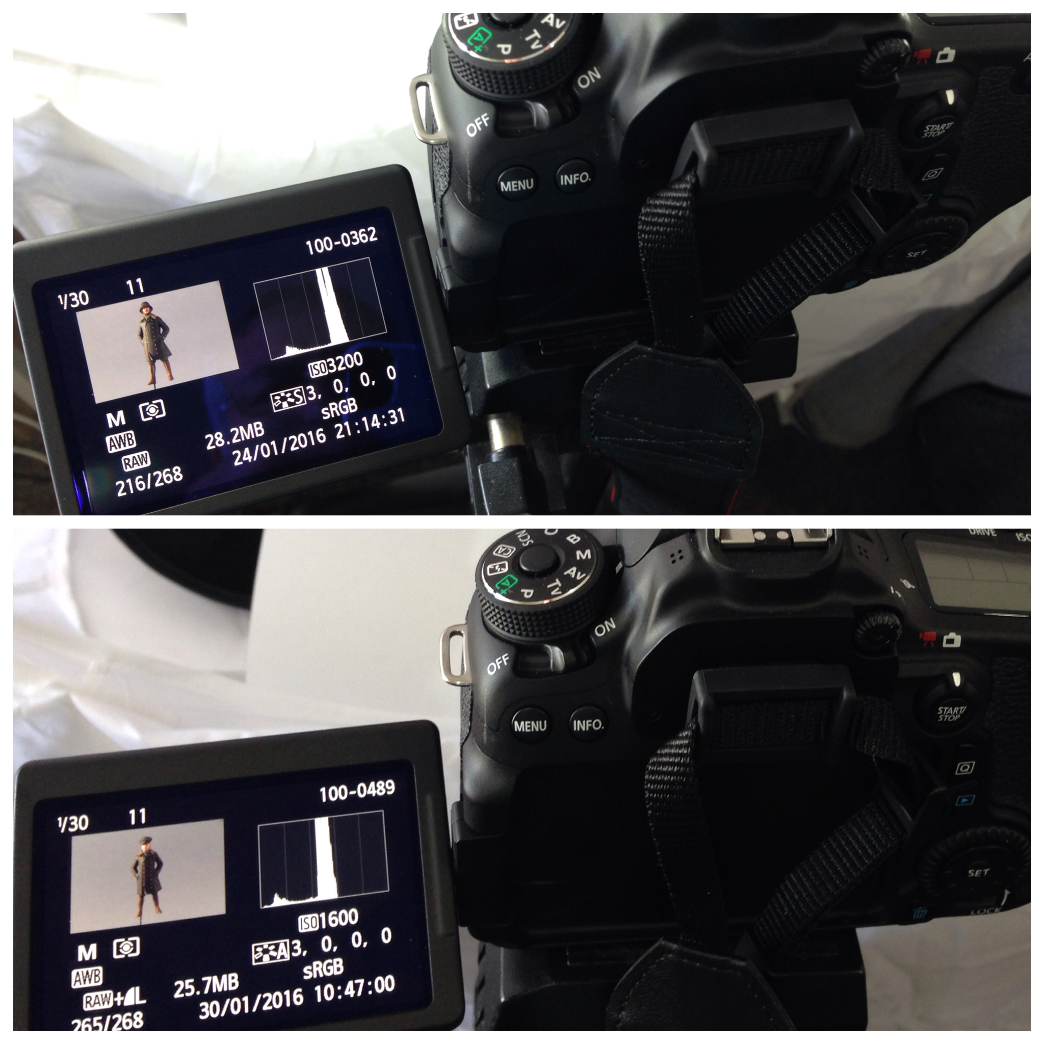

Perhaps attached images may help show my setup & images I'm having issues with.
forgive quality, just quick snaps to provide for troubleshooting here

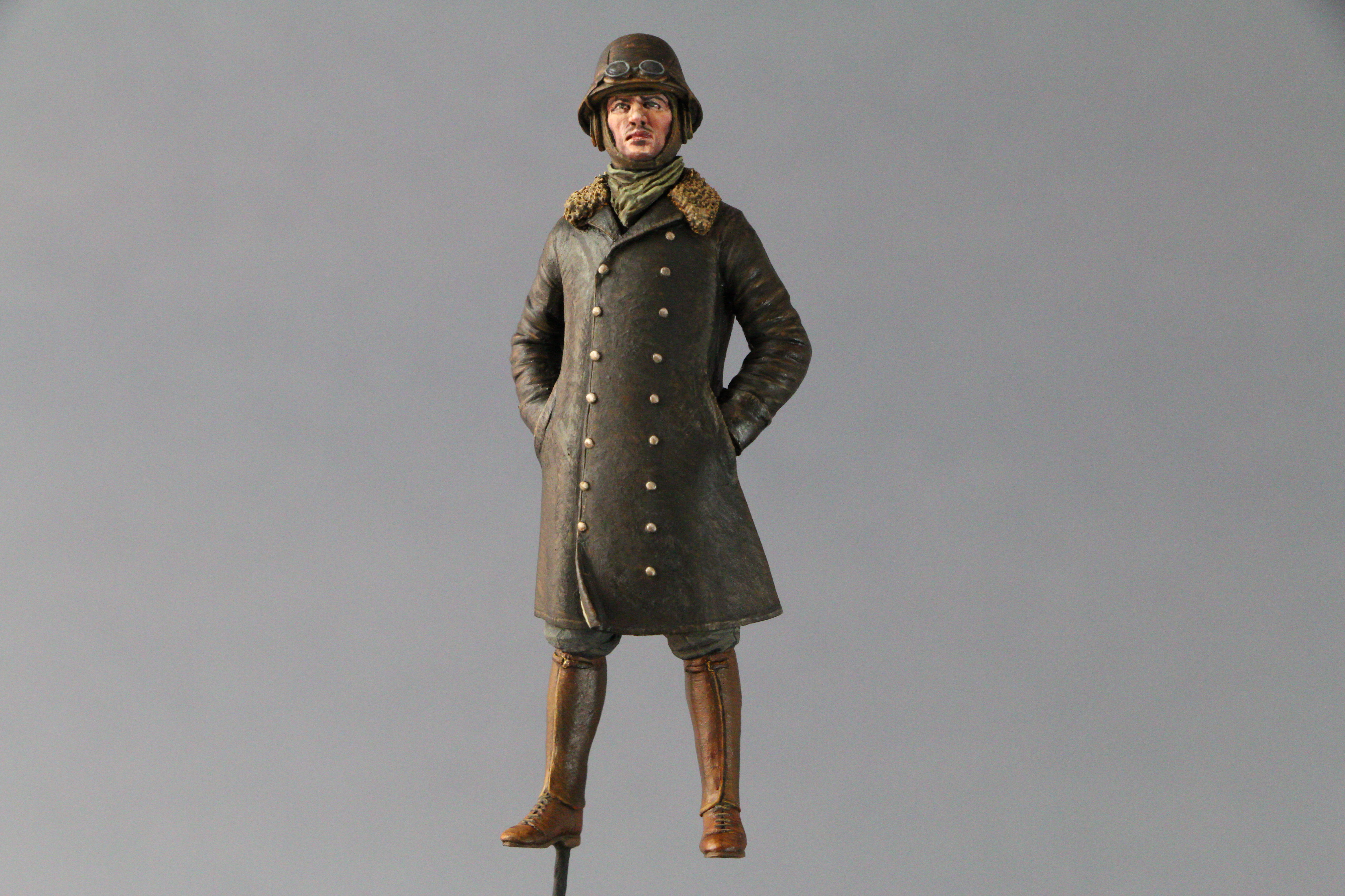

"Small RAW image
Full Size RAW image from couple of days ago

good logical problem solving, checked Liveview too, definitely set in Camera mode.
Below setting of two photos, therefore expect same resolution for each of these would appear in Lightroom.
unfortunately. Any more thoughts?
