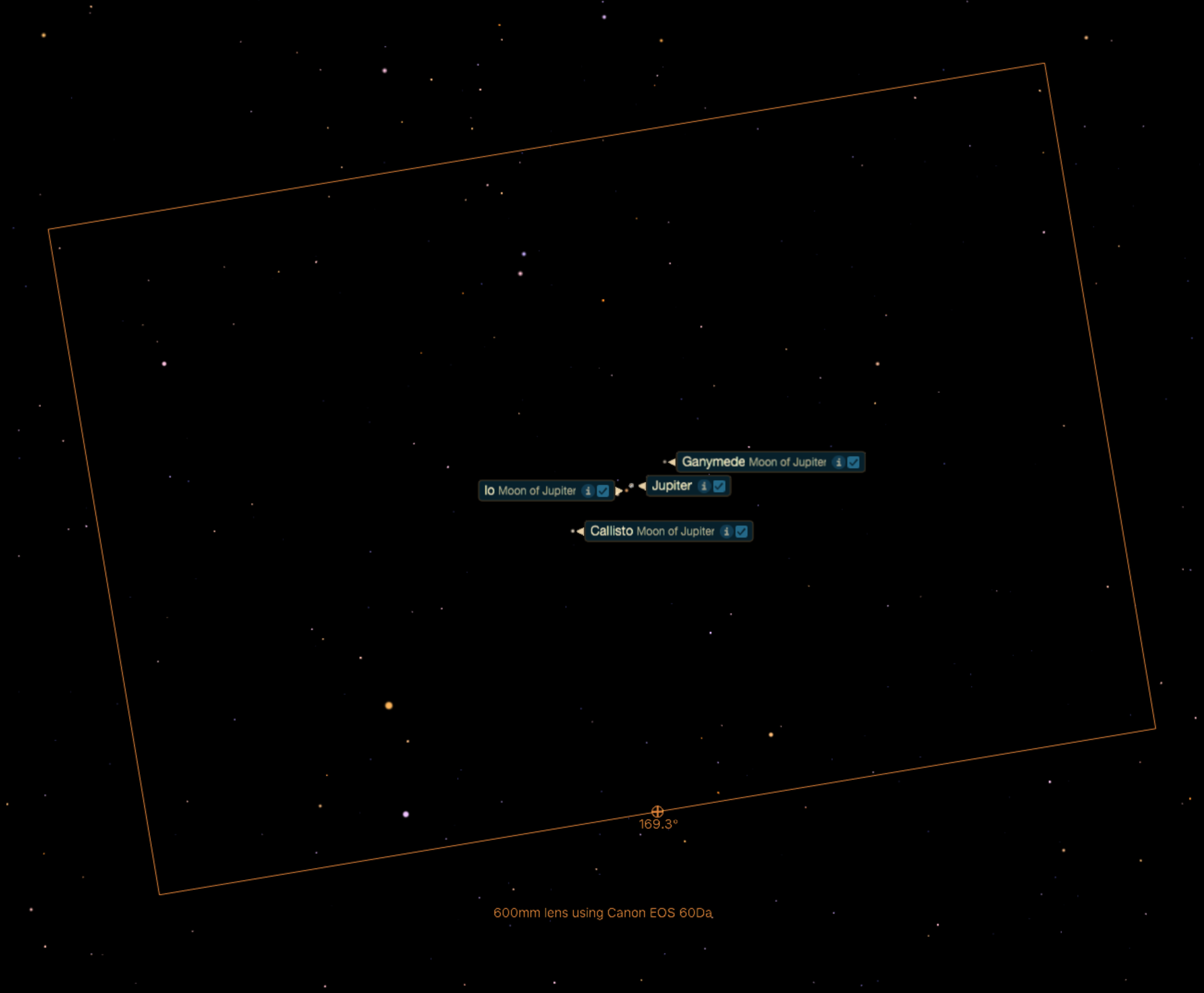

When Jupiter is nearest to Earth (and appears as large as it will be for the year), Jupiter's angular width is a mere 45 arc-seconds. Compare this to the Moon... which is typically about 30 arc-minutes. In other words Jupiter's size in the sky is about 1/40th as wide as the Moon. So that's pretty tiny.
You can see Jupiter and it's Moons even in a pair of typical bincoulars. But it will appear to be a bright dot... accompanied by 4 less-bright dots. You wont see any detail. To see detail you need magnification.
With a 600mm lens and an APS-C sensor, you're getting a magnification of about 22x.
When we use telescopes to look at Jupiter (say... an 8" SCT with a 2000mm focal length and a 10mm eyepiece) we're getting a magnification of 200x ... considerably more.
This means that you'll be able to "see" Jupiter and it's moons... but you wont resolve any detail other than tiny dots.
Here's a simulated field of view that I threw together using Starry Night Pro Plus 7 (which is what I use to plan my viewing and astro-imaging).
The above image is set to roughly 11pm Eastern Time on May 8 (not counting for DST). In this image Europa is just a tiny bit below Io ... so the software doesn't draw the label or they would be unredable.)
The orange box represents the accurate field of view for a 600mm lens on an APS-C camera.
