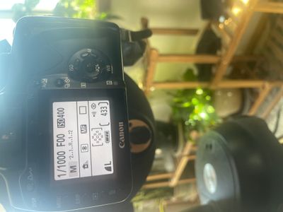

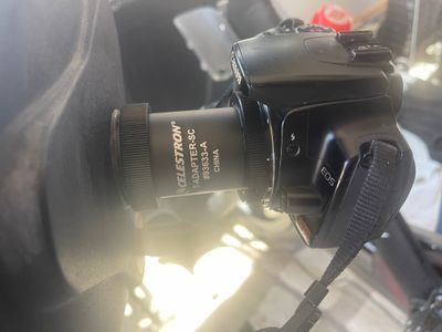

CANNON EOS XTI.  So, I took a picture of my camera screen.  Just not sure how to get a view of what the telescope is pointed at?  Couple of pics attached.
This camera is too old for live view (Seeing what the sensor sees on the LCD.) You will need to get up close and use the viewfinder.
