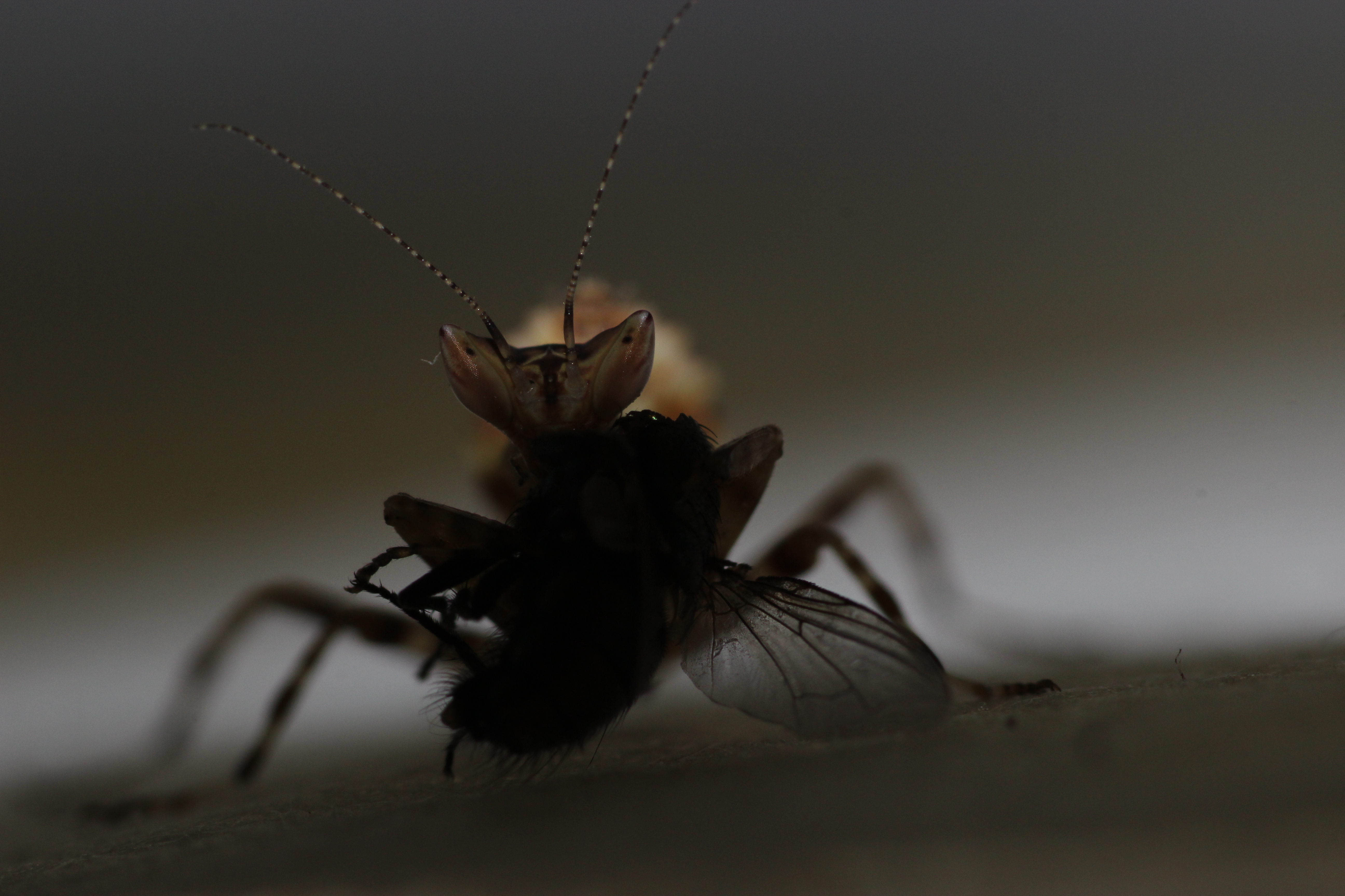

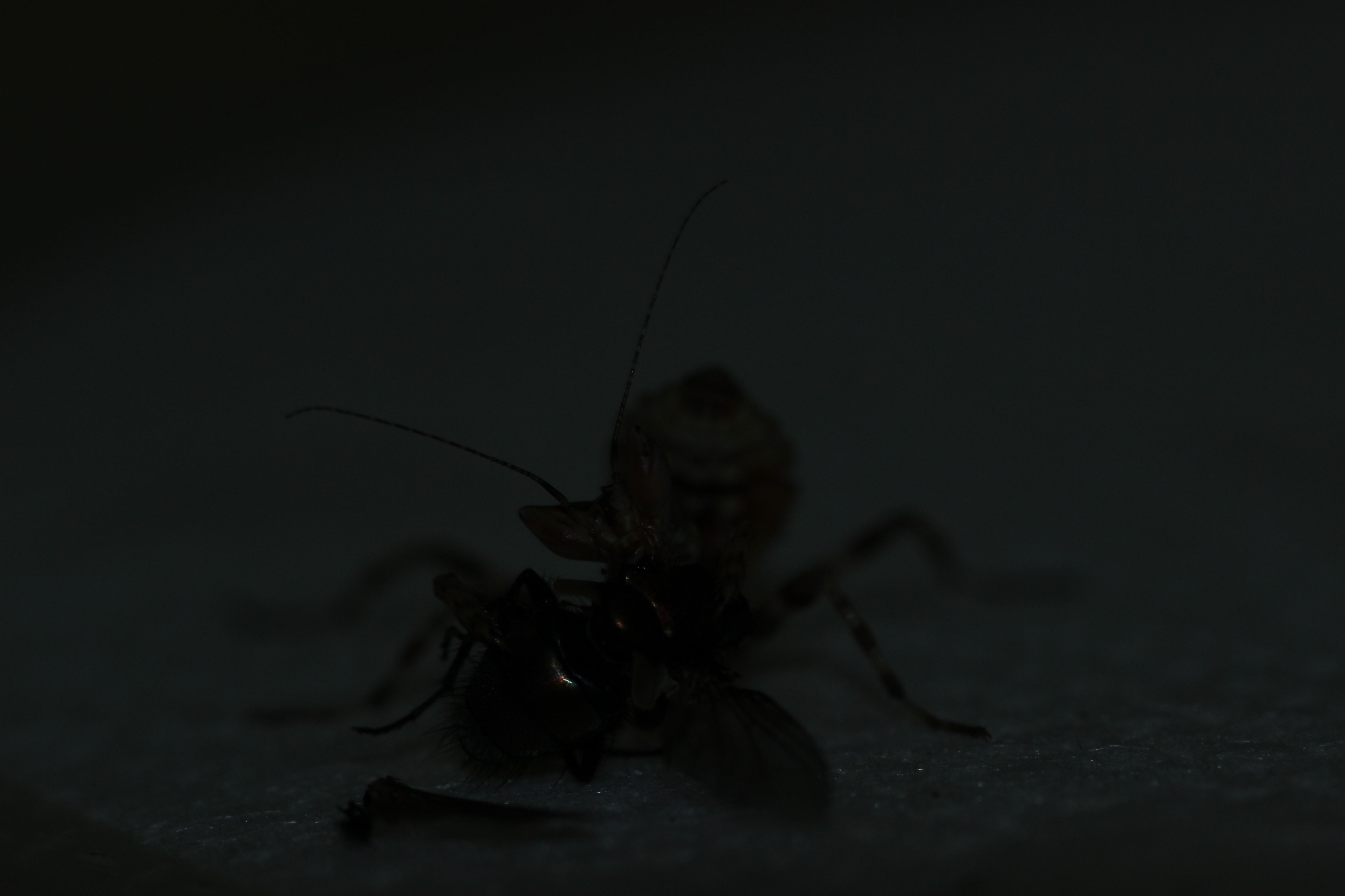

I shoot with the Canon Rebel T3i. Sometimes when taking marco (tokina marco lens with intention tubes) photography my camera (or lense) will not or can not focus on the image (in my case my praying mantis) I am shooting inside the house so lighting isnt the best but I also had my flash on aswell. Some of the pictures were coming out good but some were coming out without the flash and dark. I dont understand why this is happening. Also when I'm focusing i'm using my eye piece and the camera or lense is struggling to focus, going in and out of the subject. its like a hit or miss and im becoming very frustrated. For example check out the second & last picture, both pictures i was using flash. Im really dissappointed that the second one came out dark..... help?

The lighting is an easy one to address. In the second pic you didn't get the lighting in front of the subject, in the third it looks like the flash didn't go off at all. Properly lighting macro is difficult, as there's not a lot of room to get your light inbetween your lens and subject; especially with extension tubes. If you're using the camera's flash I'm surprised you got it to light at all. Most either use macro-specific ring lights, or just external flashes with baffles set up to reflect light in front of the subject.
As to focus: as many mentioned it's quite dark for AF to work, and you're subject is definitely close to being "too close" if not past that. That's the purpose of the extension tubes, to allow you to focus closer. That said, macro photographers mostly use manual focus (or automated focus stacking). As you're probably finding out, the depth of field is extremely small, so you really need to choose exactly where you want your focus point, not rely on the camera to choose it for you.
