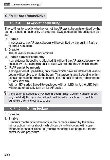

Page 300 of your T5i manual shows how to use "Custom Functions" to disable the "bzzt" sound + the flash flickering of the AF Assist.
