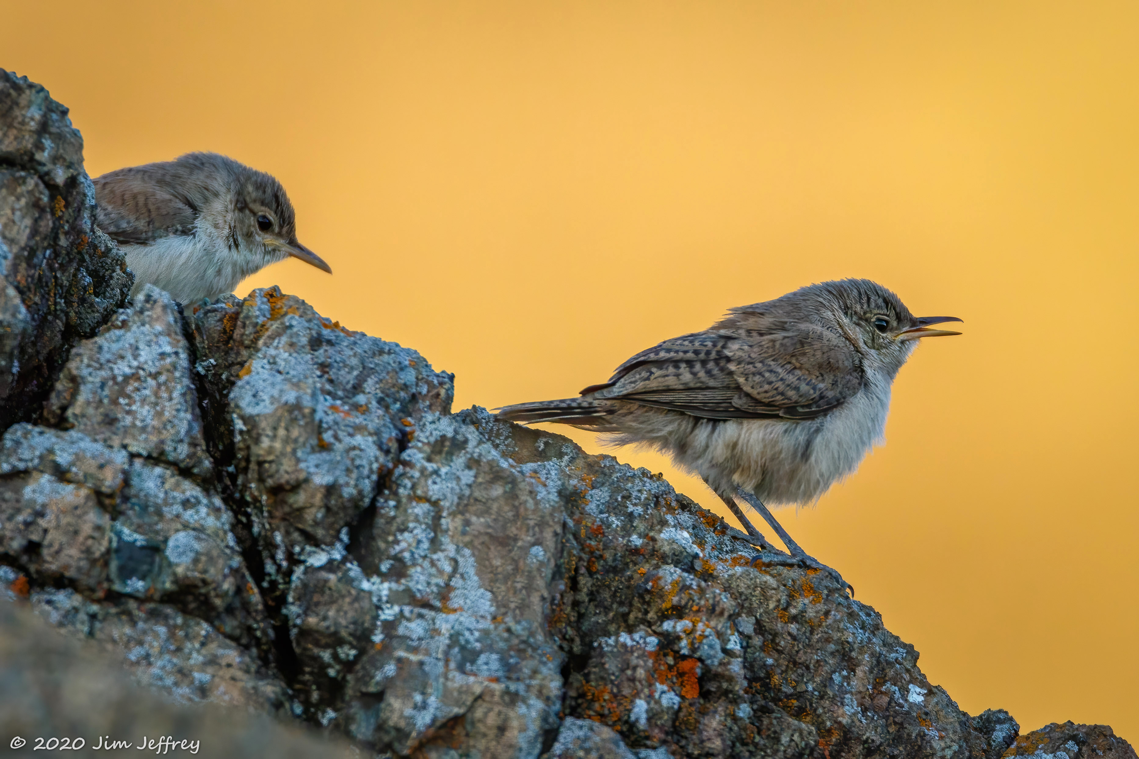

Took a close look at my Canon Extender 1.4x II today, and discovered that it had smudges on both ends of the lens. I cleaned it, and put it on the setup again (Canon Eos 7D Mark II + EF 500mm f/4 L IS USM), and then took it out to take a few photos. Here's an example of the sharpness TODAY with the gear (a couple of rock wrens). A tremendous improvement, I think. Thanks again!
Much better!  You basically did cataract surgery on your extender 🙂
Rodger
Hallelujah Smiley Happy
EB
USCRx
Hopefully, that was a large part of the issue. Like you mentioned, tho, it really pays to get to know your lens. The settings on that photo were: tripod w/ gimble head, Canon EOS 7D Mark II, 500mm EF L IS USM lens, Extender 1.4x II, ISO 1000, f/5.6, 1/1600 sec., cropped by about 1/3.
