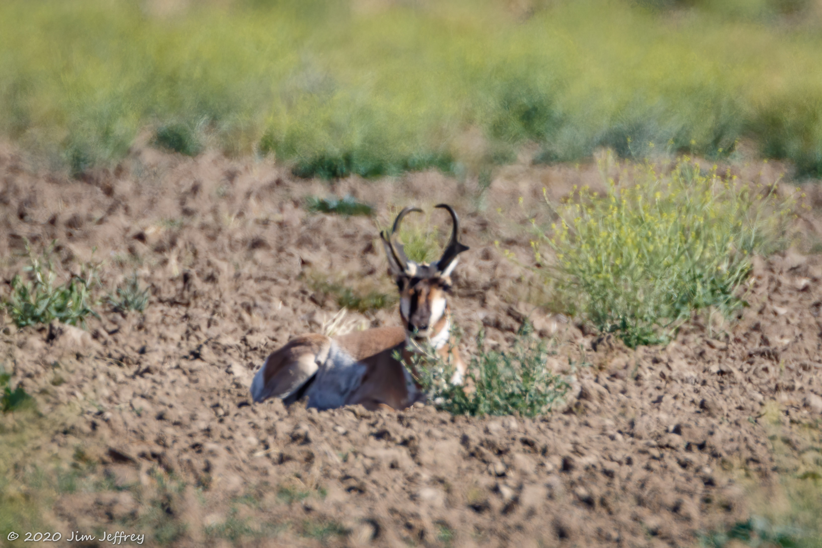

For your information, here was the shot that precipitated me not using the extender anymore: pronghorn, sitting still, 500mm + 1.4x extender, f/5.6, ISO 500, 1/3200 sec, on tripod, IS on. I must've tried ~ 20 shots of this pronghorn, trying to get a sharp image, and they were all like this one.
