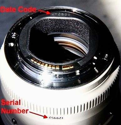

age of a used lens,   I just bought a 70-200 EF 2.8 L is USM from B&H = S/N 257[xxx] how do I determine its age, Thanks Phil

MikeSowsun
Only 10 digit serial numbers can be decoded for date of manufacture. It is highly unlikely your lens was manufactured in July 2023.
A 70-200mm lens with a 6 digit serial number should have an alpha numeric date code stamped on the lens mount area.
Mike Sowsun
Mike,  this lens date code on the mounting ring area is US0707, do I understand by looking at this number it was built for the US in july of 2007 = it's 18 years old ? is this right.
No, a US0707 date code means your lens was manufactured in July of 2004, making it 21 years old.
The first letter was the manufacturing plant. "U" means Canon's Utsunomiya, Japan factory.
The second letter is the year. “S” means 2004.
07 means July, and the last two digits don’t represent anything.
There is no way to tell which market the lens was sold in. They are manufactured in various factories, to the same specs. It is just the warranty that differs.
