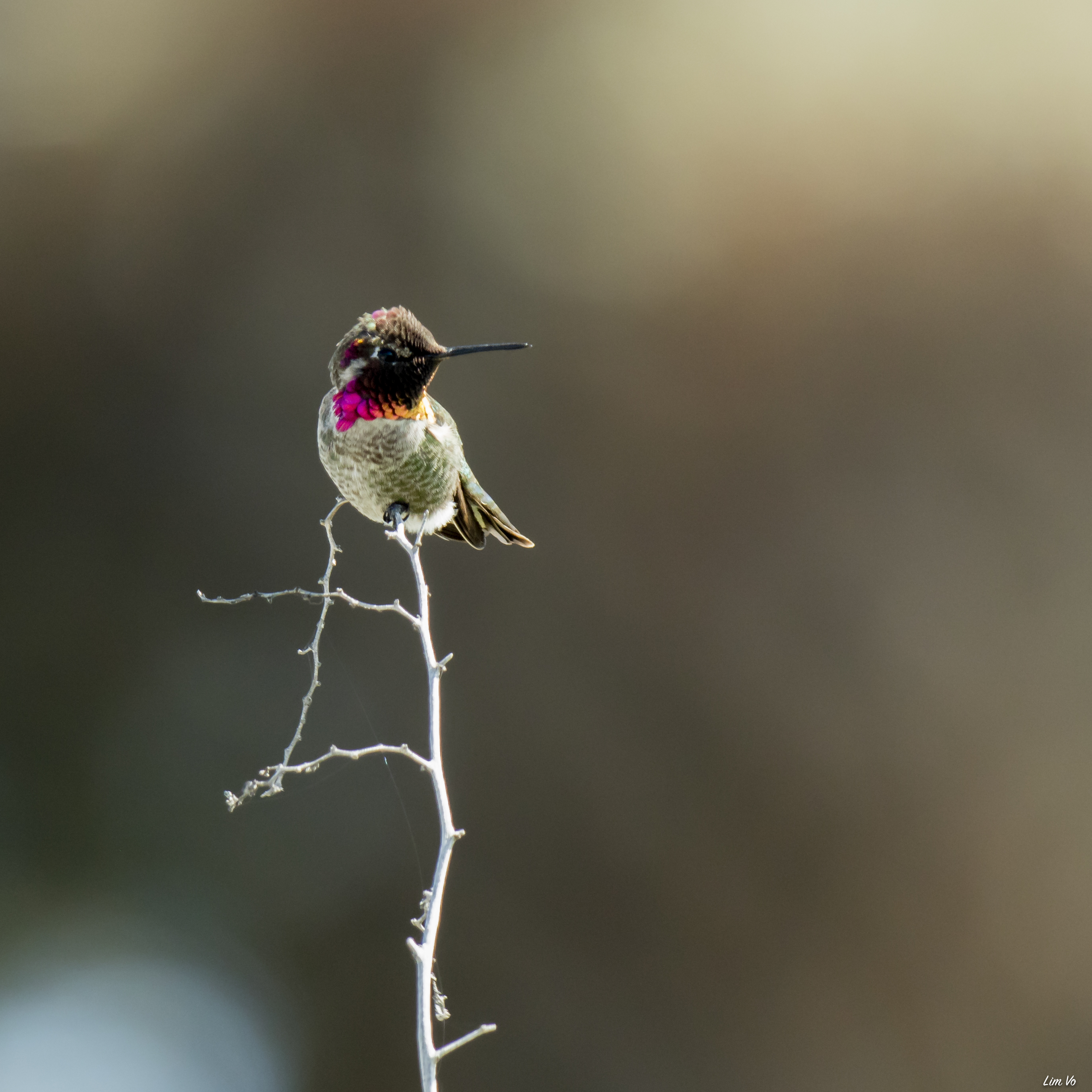

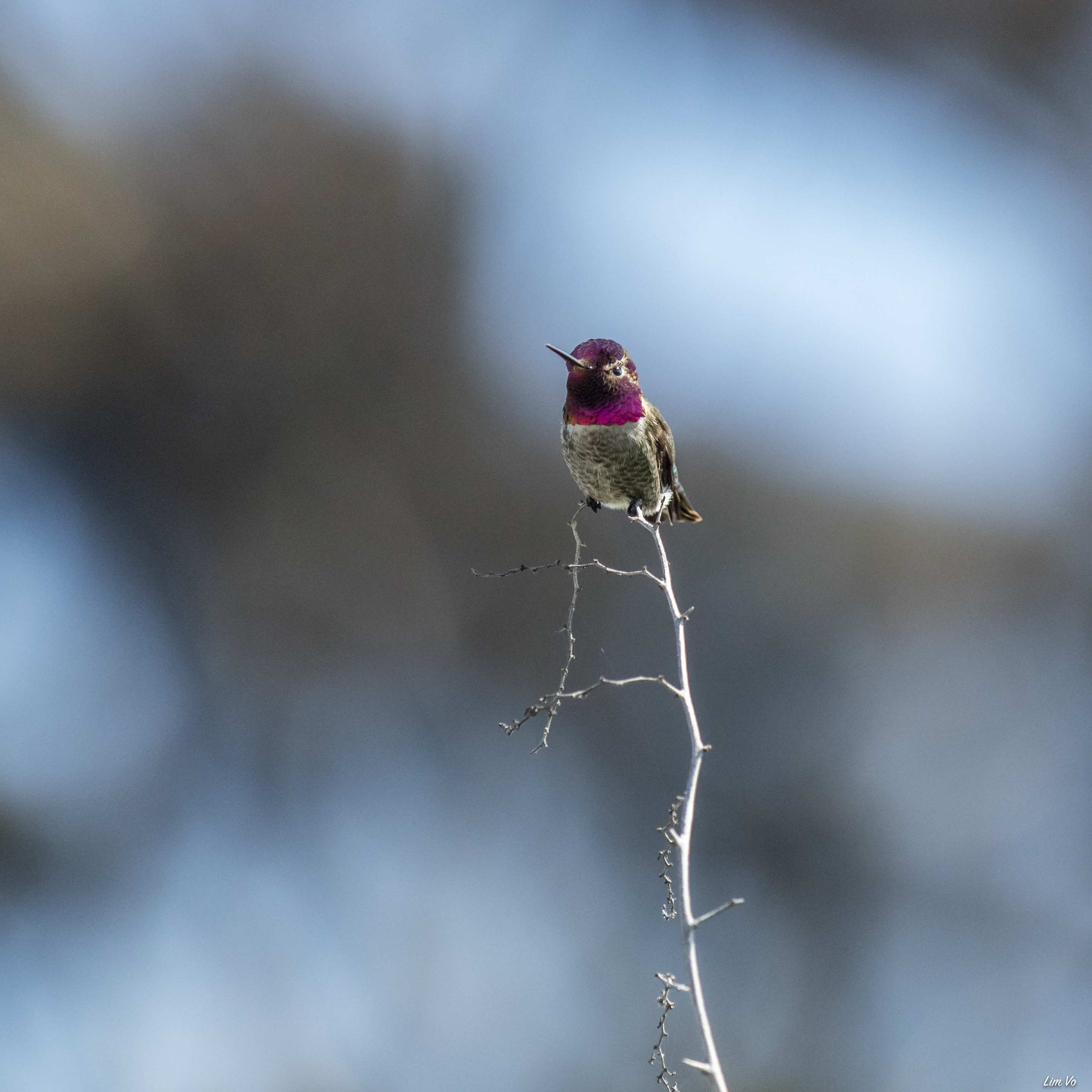

Rodger, thank you for answering my question. I do have a 2x converter and below are test images taken with 70-200mm Mark ii. Can you tell which photo was taken with the converter and which isn't?

Image 1L7A8459 shows a bit of loss of sharpness and contrast along with some increased CA that occurs with converters but I was specifically looking for a difference. If you blew them both up to a very large print size it would be noticeable but someone looking at a gallery of images wouldn't be likely to notice.
In the digital age, there are a lot more "pixel peepers" because it is easy to do instead of using a magnifying glass like the film days. It reminds me of a very old electronics advertisement where an owner was so worried that his turntable pickup wasn't performing properly that instead of listening to and enjoying his albums he was studying the waveforms on an oscilloscope to look for distortion. Extreme pixel peeping is the same illness.
The primes you listed will take the 1.4X and 2X even better than your 70-200 F2.8 and will produce some excellent images. My major caution about using the converters with any of these lenses is the result won't be as good as the bare lens which is excellent and the reason for putting up with the expense, weight, and reduced versatility of a prime versus a zoom but it will still be very good even with the converter. Canon certainly felt comfortable about recommending both converters for their very expensive EF 400 F2.8 IS II which I own because the storage case comes with molded cushioned storage locations for both in the included hard case. I have the 200 F2, 300 F2.8, and 400 F2.8 and the converters are very usable with these primes.

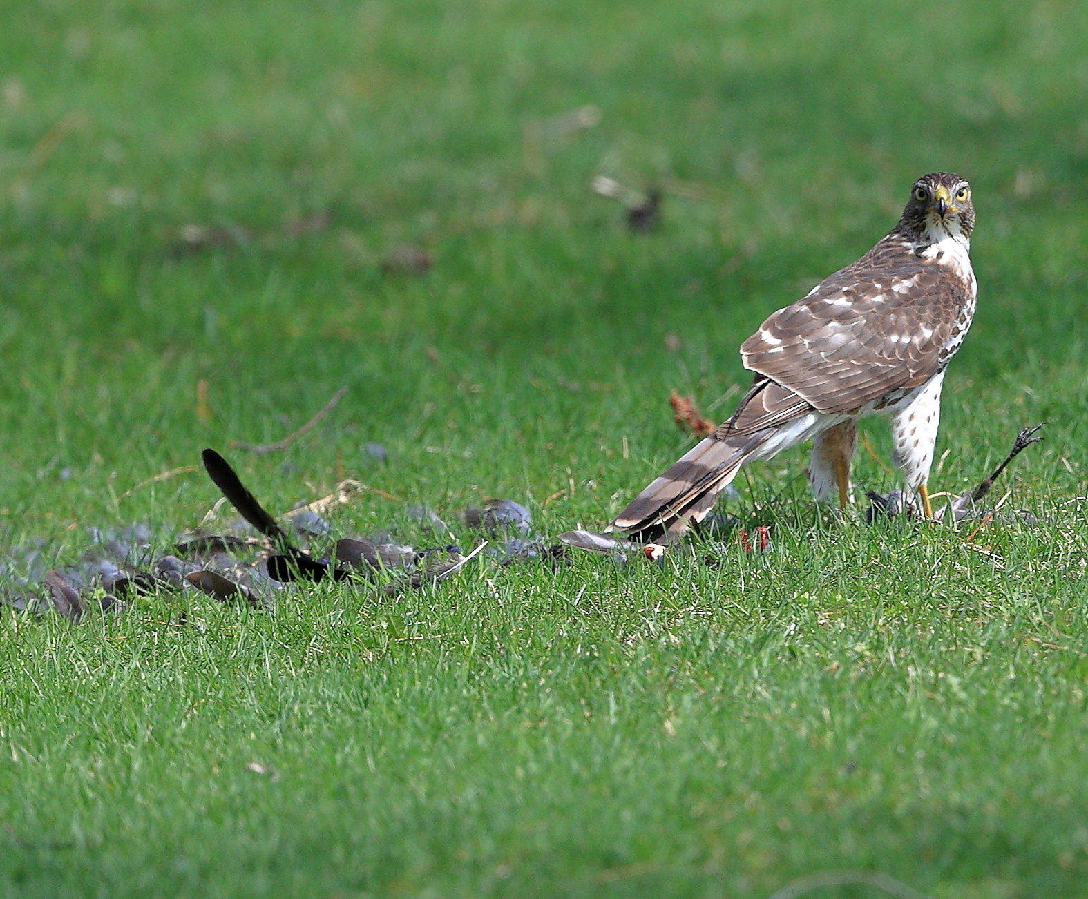

This shot of a hawk having an appetizer was taken with the EF 400 and 1.4X and the resulting image is cropped from 10% of the 1DX III sensor area. Unfortunately he was having a tiny snack and didn't stick around long enough for me to capture him with the 2X converter for comparison.

"Can you tell which photo was taken with the converter and which isn't?"
You didn't but there is a lot, way lot, more aberration in the top photo so I say it is the 2x tel-con. Also may I suggest less saturation in post. Almost always less is more.
I can't see the eye in the top picture but the eye in the bottom is nice and sharp. If I look at the breast feathers there is less definition in the top shot.
All that said, I doesn't make a hill of beans what I or Rodger think about the shots, if you are happy than it's a go. And, it depends on how you intend to use your photos. If you are posting to a web site all is good. Nobody will be able to see much difference. On the other hand if you intend to make 8x10 or 11x14 prints, yeah, it will likely show up.
04-24-2020 05:57 PM
You are correct, the top photo was taken with the converter. Both photos were heavily cropped, the posted photos are 3MB in size, cropped from 50MB photos. Also, to be accurate, I moved a lot closer to the bird in the second photo, otherwise, it would be too small to see with a 200mm lens.
