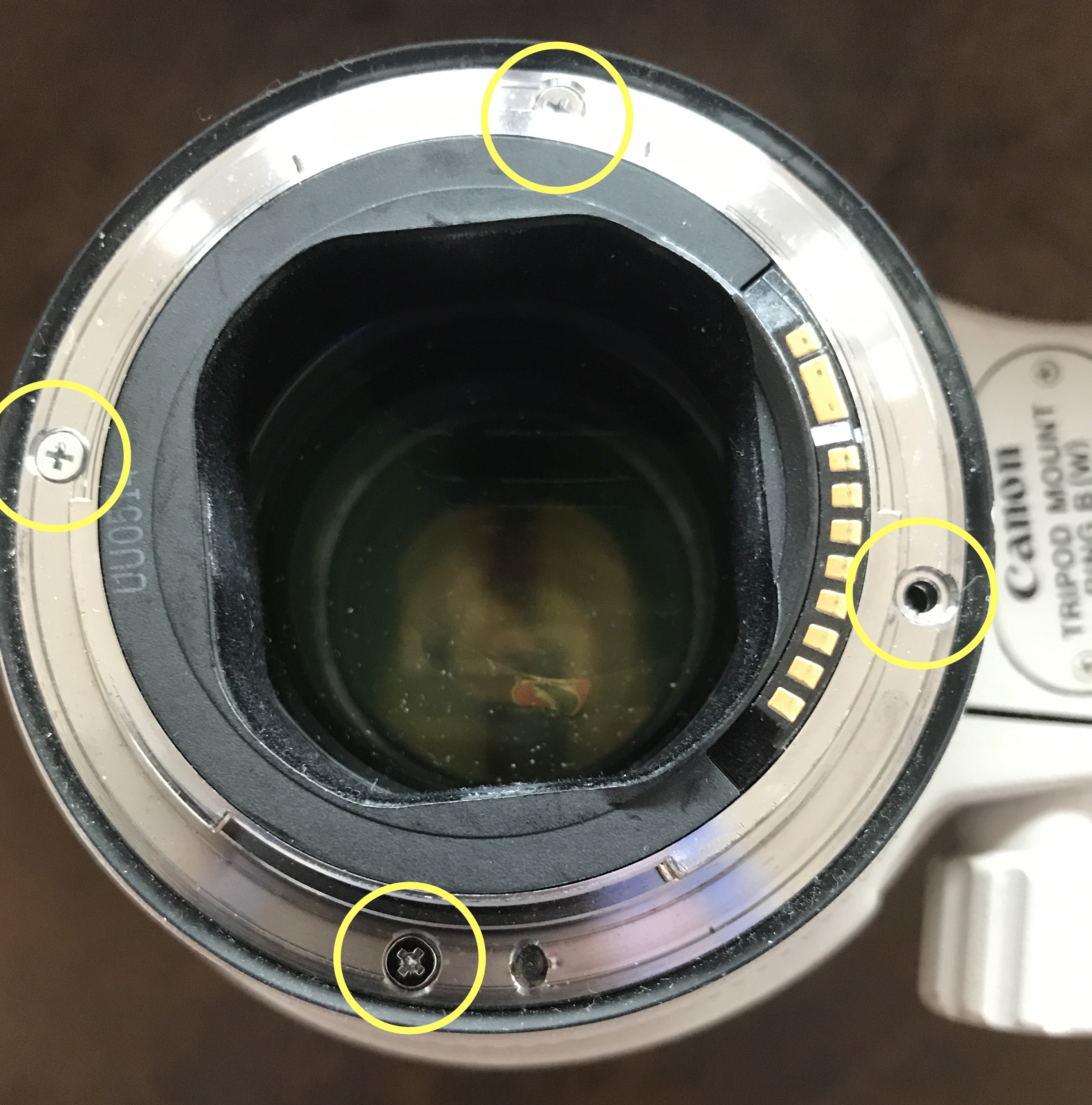

Three of the four screws in my 70-200 2.8L IS lens magically disappeared on the same day...I can't find anywhere online what size they are. I can't afford to send the lens into Canon - I'm sure if I can find the screws, I'm capable of screwing them in, lol.
The screws in question are the in the ring closest to the camera body. Picture attached for reference. Thanks!

Call Canon at 1-800-OK-CANON and order part XA9-1306.
Or Google that part number and order via eBay. Forum rules dont allow posting a link.

Thank you soo much... Looks like $29 a screw and I need three....

I'd suggest a very small amount of blue Locktite on the threads, to keep the screws from loosening again. You want to be very careful not to use too much Locktite, to be sure it doesn't get inside the lens.

Anyone know what the name/size of the screw for the Canon 70-200 2.8 lense: attached is a photo. Thx in advance yo anyone who can help.
I believe this is the part you need. Canon XA1-7200-706 EF Screws.
Contact USCAMERA-dot-com.
