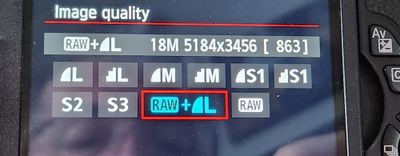

this is what I took that in. So, I should shift it to just Raw?
12-15-2024 04:47 PM
You'll likely get different answers to this because people tend to use a variety of workflows.Like you i set the camera to have both RAW and jpeg.
JPEG is convenient for browsing pictures on the computer,while the RAW version is perfect for the best images (when i get them,not often 😅)

" this is what I took that in. So, I should shift it to just Raw?"
There is no good reason to use jpg, IMHO, none. With today cameras, editors and computers using raw is no more inconvenient than jpg. Shooting raw+jpg just uses up more space on the SD on CF cards. Does it hurt anything no I suppose not but it is just not necessary.
On the off rare chance where you may need a quick unedited transfer of images I guess you might make a case but a very slim one at that. However if that occasion arises it is a simple menu setting.
