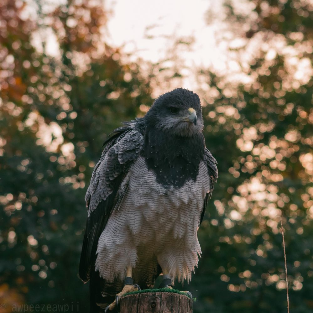

This is a photo I took at f/5.6, as you can tell if you zoom in, it's very soft despite being properly focused.
janesbenth1
This is a photograph I took with an aperture of f/5.6; if you enlarge it, you will notice that the image is somewhat fuzzy even though the focus is spot on.

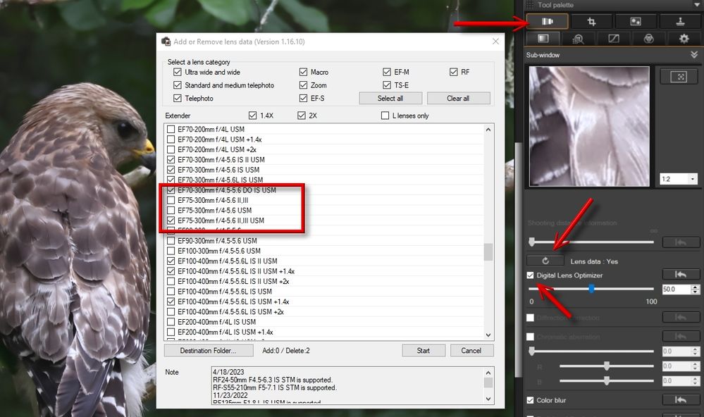

I use Digital Photo Professional 4 (DPP 4) to clean them up. The Digital Lens Optimizer in the Lens Correction panel does a decent job on my older lenses. I assume other programs will do this to a degree, but Canon knows Canon lenses better than anyone and I get good results. The image attached shows you where to find DLO and how to download the profile for whichever EF 75-300 lens you have (you don't say in your post).
I also sometimes run them through Topaz Sharpen AI if DPP doesn't do the job to my satisfaction, but it costs $$ where DPP 4 is free. As mentioned, images taken with this lens can be made better in post, whether it's DPP, Topaz, or PhotoShop. I mainly use DPP because it's free and I don't need any more tools for my bird photography than what DPP offers 😊
**Edit: I forgot to mention that DLO is only available to Raw images and will not work with JPeG, so I hope you are shooting Raw.
