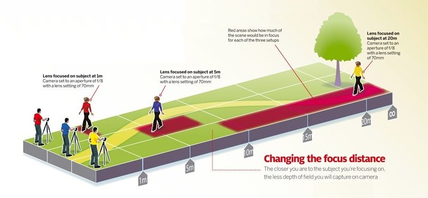

Just one point ... for me the actual DoF depends on:
Focal length - the longer the shallower the DoF
Aperture - the smaller the f/stop the shallower the DoF
Distance to subject: (as opposed to minimum focusing distance) the closer the subject the shallower the DoF.  I totally get your point that the closer one can focus, the less DoF one can get and I think that is more the theme of your post.
On a more general basis. To me that is a function of the distal relationship with the subject, rather than the potential minimum distance, so the variation in DoF relative to subject distance extends out past that, as per this:
What do you think?

Wouldn't minimum focusing distance be equal to distance to subject?

Not really.  Minimum focus distance indicates the closest potential distance that a lens can find focus on a subject. As I understand it, subject distance is a variable from that (minimum focus distance), out to infinity.  So, distance to subject could be 1m, 10m, 100m or a km and as that value increases, so does the DoF.

Gotcha.  I still think they are equivalent though for this exercise since the distance between the actual focal plane and the "start" and "end" of the DOF region is mere millimeters for most part.

I totally agree that for the absolutely smallest DoF, the minimal focusing distance will be applicable.  I am simply making the observation that this is a relationship of subject distance that continues as the it varies from that - so more of a generalized observation that actually underpins your point - I hope!
