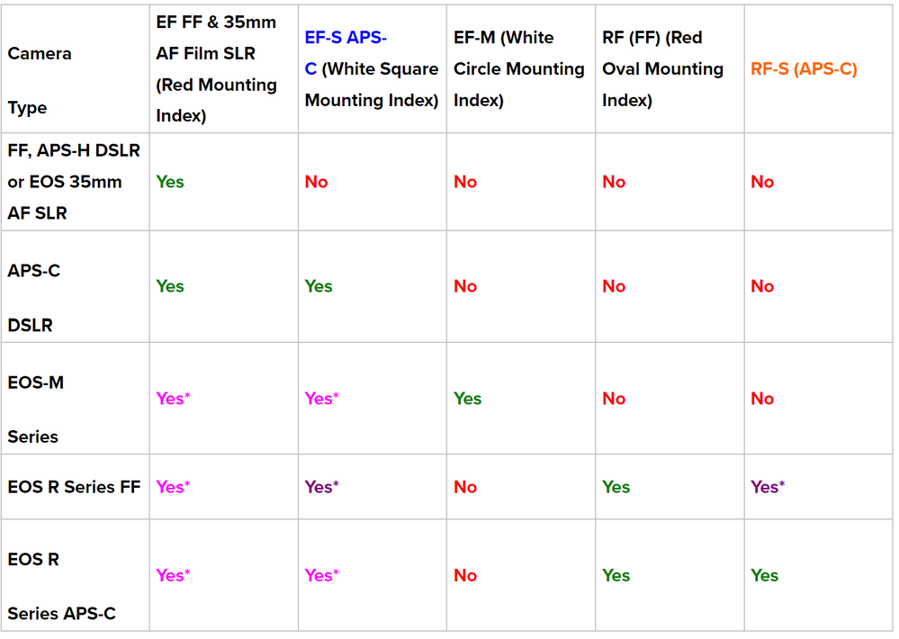

I have the eos rebel t6i and I’ve been wanting to start doing wildlife photography, I seen that the rf 800mm f11 was a good lens to get close ups for a decent price. Would I be able to use it with my camera ?

No.  An RF lens requires an R-series camera.  Your camera can only work with EF and EF-S lenses.  And, it's not possible for there to exist an adapter that would allow RF lenses to work with EF-mount cameras.

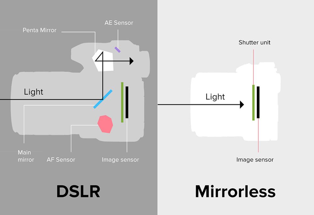

No RF lenses aren't compatible with any of Canon's DSLR cameras. It is also not physically possible to adapt the lens either. RF lenses have to physically sit closer to the image sensor. But in a DSLR camera the mirror is in the way so its not possible. EF lenses can be adapted to the EOS R series mirrorless cameras. This is because the adapter puts an EF lens at the correct distance from the image sensor. Since EF lenses were designed to sit further away from the image sensor due to the reflex mirror and optical viewfinder system. Lens compatibilty .pngLens Compatibilty PT. 1.png
