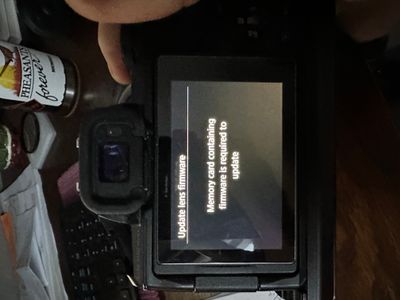

I have been using a Canon EF 50mm f/1.8 STM on my Canon M50 Mark II for quite some time with no issues. The other day I was shooting with it and when I turned the camera on I received a notification for Update Lens Firmware - “memory card containing firmware is required to update.” The problem is I can’t find ANY firmware update for that lens. I did subsequently update the camera’s firmware but still received the lense error. All other lenses work fine.

thanks for taking the time to help with my question. So, for all other lenses I have this works, and firmware is up to date. For my 50mm lens in question, I can’t even get to my menu on the camera. When I turn it on, this is all I get and cannot continue to any other camera functionality (again, just for my 50mm lens).
when I turn on the camera I get this message:
I then select OK and get this message:
I cannot move past this screen. I’m stuck here. On Canon’s website there is no available firmware for the lens so not sure what to do at this point.

No go. Bought another card and reloaded camera firmware v1.0.3 for the M50 mii, which is the current firmware on Canon’s website, and I’ll still getting the error that I need to update the firmware, and then that there’s no card detected when only this lens is connected. All other lenses work just fine.
