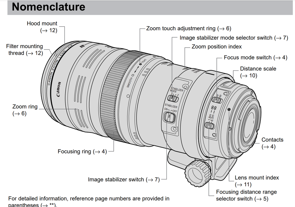

The focus rings wont turn.
Will the focus ring turn with the AF/ MF switch set to MF. If NOT your lens needs to be sent in for repair. The focus ring should turn even with the lens set to AF. Make sure your turning the smaller ring of the two on the lens. Link to Manual for Lens

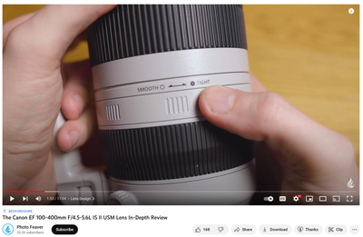

Could it be the smooth <-> tight ring is set for "tight"?  see this video from 1:50
(6) The Canon EF 100-400mm F/4.5-5.6L IS II USM Lens In-Depth Review - YouTube
