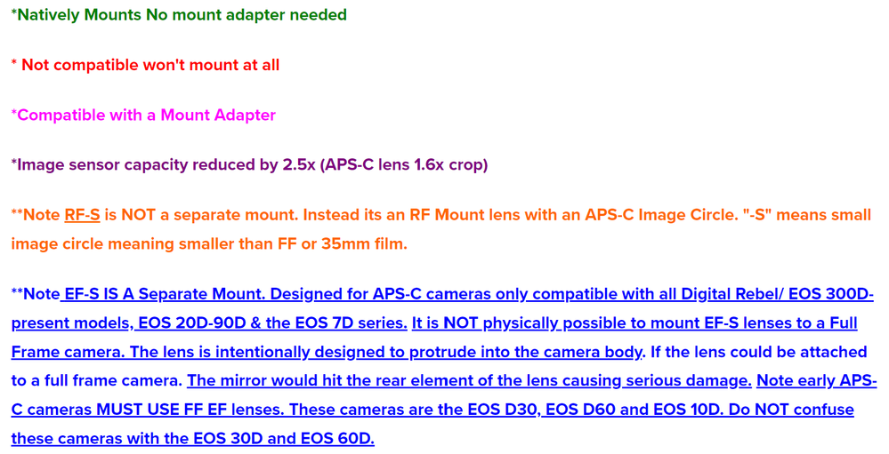

  5. Your camera uses what is called Canon EF & EF-S Mount lenses you have a DSLR camera. You can't attach or use EF-M, RF & RF-S lenses. There isn't an adapter that will make these lenses work. These lenses are designed for mirrorless cameras and are incompatible with DSLR cameras.

Here is a lens compatibility chart below.
-Demetrius
