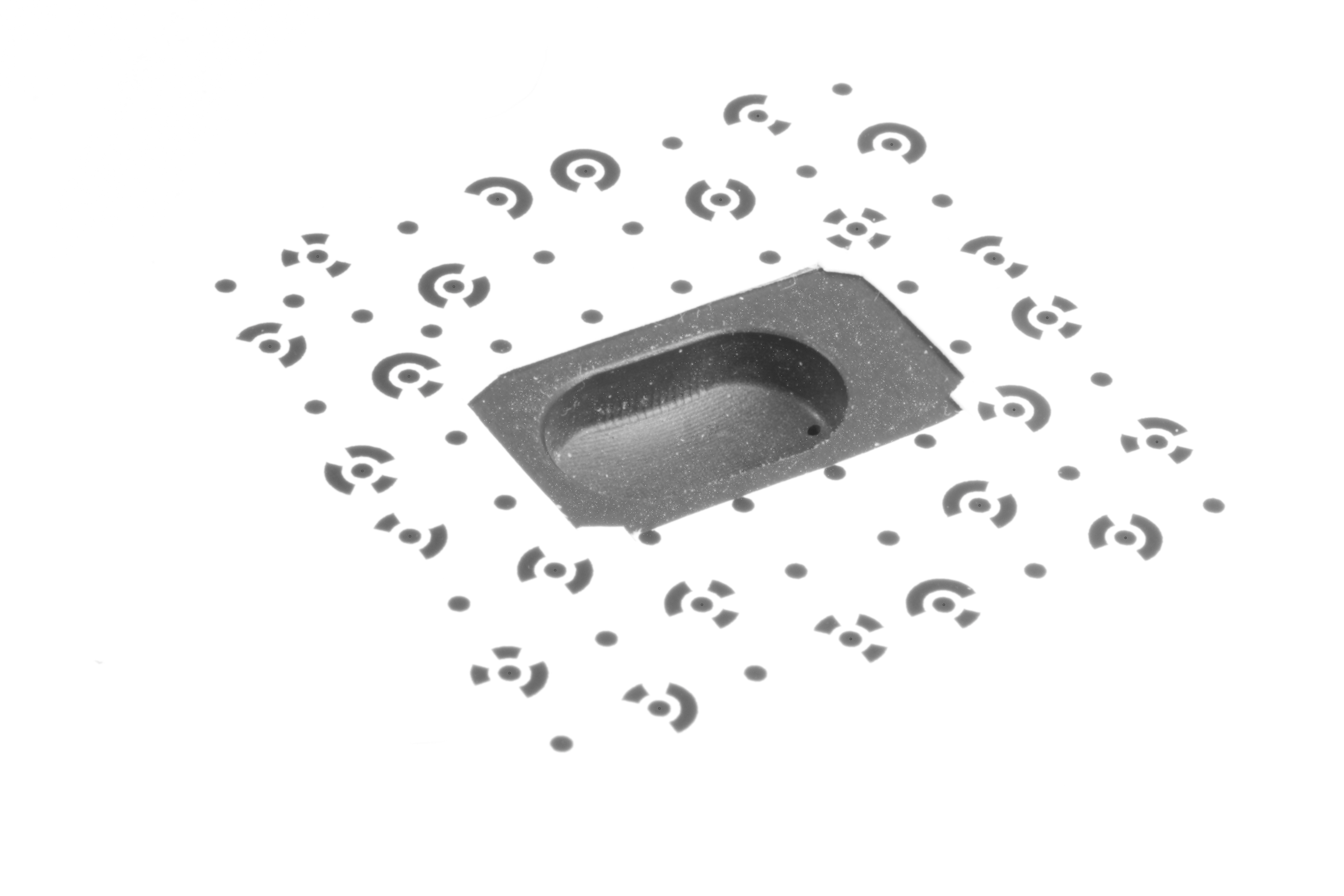

This may not be anything you have seen before. For details go to the PhotoModeler website. I'm taking this technology beyond anything they show on their web site. The images here were taken with my 7D and an EF-S 60mm macro lens. All photos are taken using B&W settings because that's what the software converts them to anyway.
The software I'm using is PhotoModeler Scanner. Here's a typical photo with the 'Smart Points' shown.
The cavity I am trying to measure is in the center of the image. Surrounding it are coded targets printed on a piece of glossy paper and taped to the surface of the tool.
06-23-2013 08:32 PM
I pushed the wrong button and sent this before I was ready....
Continuing
The surrounding targets are printed on 5mm centers and are automatically recognized by the software. A photo is taken every 15°, resulting in a set of 24 photos. These targets allow the software to determine the camera position for each image. If you look carefully at the cavity, you will see many white dots. These are the 'Smart Points.' I do not know what the software detects on the surface, but it identifies 'unique' surface characteristics and tracks them between adjacent images.

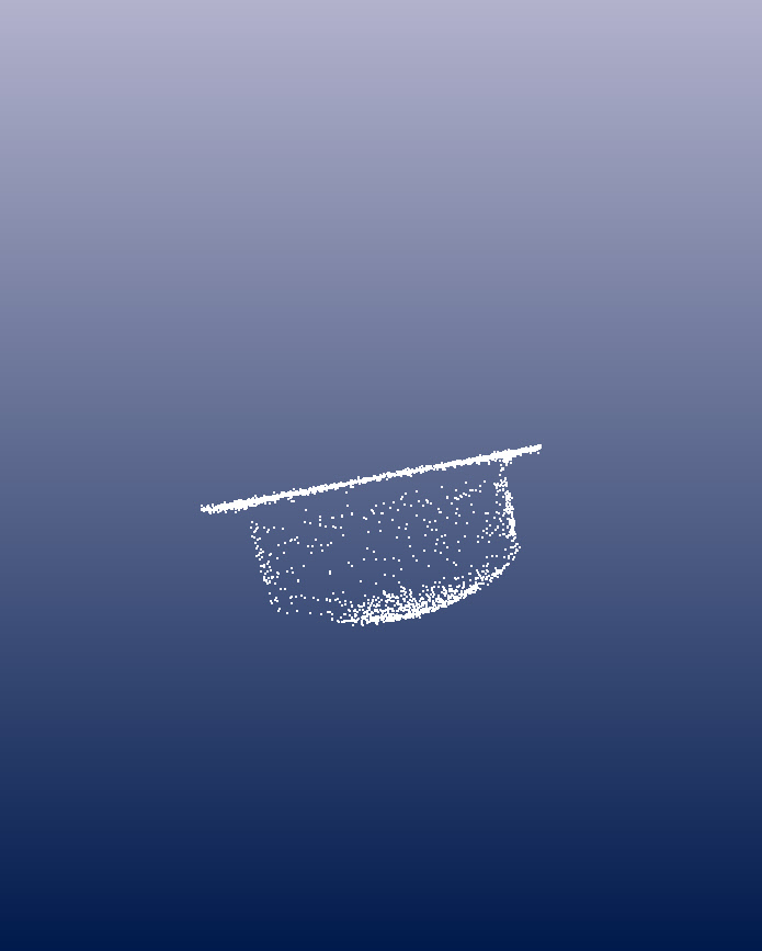

When you tell the software to compute the locations of all those points, it gets interesting. I'm running an Intel i7 CPU running at over 3 GHz with 16 Gb of memoryon a 64 bit system. It still takes 3 to 4 minutes for it to run all the calculations. That's a LOT of computation. The output is a point cloud that when viewed from one end looks like this:
The reference targets are not shown. The problem is the noise. Looking at the horizontal top surface, all the points should be in the same plane, but there are many points that are above and below the bulk of the data. To date I have been using a non-linear regression program to fit surfaces to these points, and then stripping out any that were in excess of 6 sigma from the calculated plane and then running the regression again on the remaining points. It works, but it is not very satisfactory.
The source of the problem is the focal length of the lens. Although the lens is listed as 60mm focal length, when you get up close it increases to about 100mm. The focal length is calculated during a lens calibration procedure that determines distortion and some other characteristics in addition to focal length. As focal length increases, the light rays creating the image become more parallel. This results in a much higher potential for error, thus my interest in using a wide angle prime lens for marco photography.
