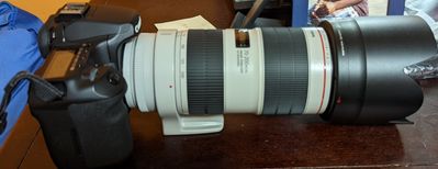

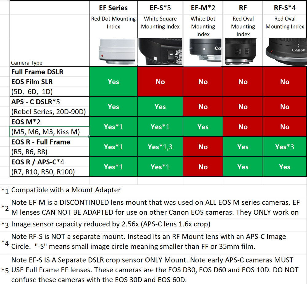

No not true EF lenses are always compatible on APS-C DSLRs. All L is a designation for professional level lens. The incompatibility is the other way EF-S lenses cannot be used on Full Frame cameras. There has never been an EF-S L lens. As you can see below in the lens compatibility chart. EF lenses are compatible on EF-S cameras. EF lenses can be L or non L. I have a picture below of my old EOS 40D with an EF 70-200mm F/2.8L IS III USM lens mounted on it. The EOS 40D is an APS-C camera and everything works just fine with it with that lens. No incompatibilities.
