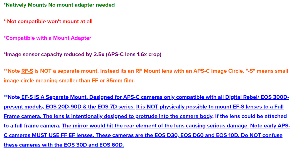

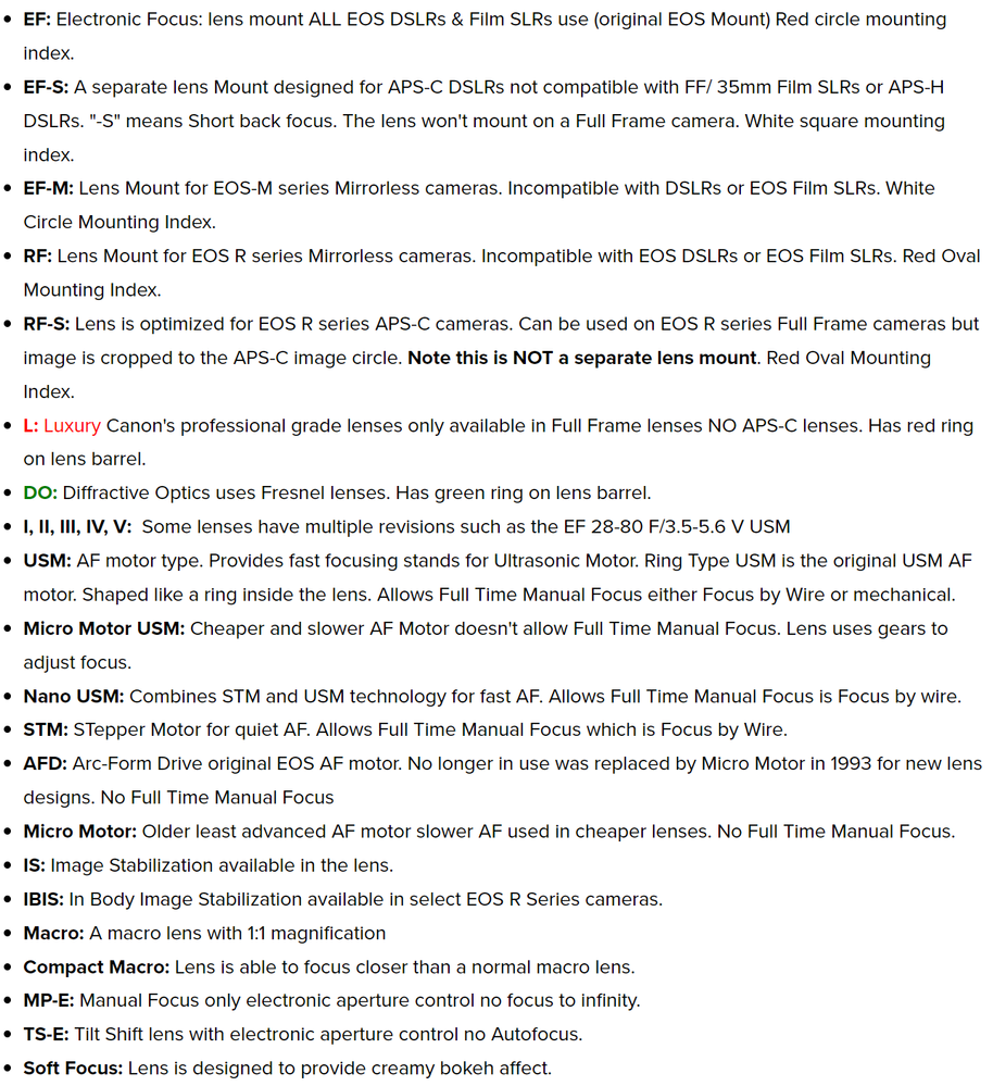

Yes you can use ANY Full Frame EF Mount lens on your camera. You aren't restricted to only EF-S lenses only. Your camera will mount BOTH EF & EF-S lenses but NOT EF-M, RF & RF-S. Those lenses are specifically designed for mirrorless cameras NOT DSLR cameras. Canon does make an EF 600mm F/4L IS III USM. But what is your budget spend on a lens. Your camera has an APS-C sensor which has a crop factor of 1.6x applied to all lenses. Regardless of the lens being designed for APS-C or Full Frame. So your lenses will provide a narrow angle of view. A 600mm lens would provide an angle of view of 960mm when compared to Full Frame.
Lens compatibilty .pngLens Compatibilty PT. 1.pngLens compatibilty PT. 2.png

Demetrius, that is quite a list. I find a bunch of things that are informative. With your permission, I would like to cut and paste it to Word, print for reference in my Canon file. Thanks.
John
Yes that's fine but I should've added "won't Mount at all, not possible to adapt. And a few other things like E-TTL, E-TTL II, A-TTL, TTL. A-TTL and TTL have been discontinued and phased out so have the original E-TTL algorithm. Which has been replaced by E-TTL II.
