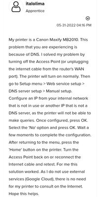

Thanks so much for your information about fixing the power cycle problem in MX490.

MX490 power cycling fix from user on forum SPREAD THE WORD!
Here is the fix everyone! Thanks, italolima

When following this proceidure, I found the initial IP address on the printer as 192.168.1.1 This is the router IP address. That would create a recycling problem.

Sorry if this is a naive question, but if you do this fix, is it essentially the same as of you hardwired? I don't have a working computer right now so we print from our phones to the printer, I was under the impression to do this WiFi has to be on?

This is happening to a user of mine. Started yesterday, like all the rest. Not sure I understand how it can be a DNS issue.

You’ll be fine. I can still print from my phone. This just stops internet access from functioning properly. Local Wi-Fi is unaffected.

I was able to get my printer working again-- doing essentially what is outlined in the fix shown above...........once the network info was entered manually and the printer came back up and connected to the wifi-things were almost normal.........I was able to print from my cellphone (apple) and my Ipad without having to do anything else to those devices...was just like problem never happened........on two Windows devices ( windows 10 and windows xp) the systems could not see the printer and after trying a few diagnostics, it was easier to simply go to control panel and remove the printer .then reinstall the driver from the canon support site and add the printer back in......no issues .......... so - no it is not like being hard wired once you get the printer straightened out....but depending on your devices you may need to add the printer in again to clear u the network issues that were created.....
hope that is helpful and didn't add any more confusion! we've had enough for now!!!

What network info are we supposed to add manually?? What does it mean "configure an IP address"?
