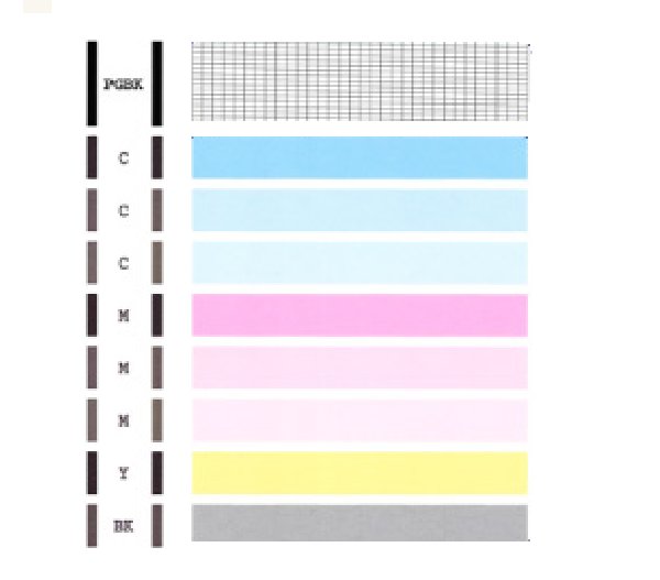

Please follow these steps:
1. Press <HOME> on your PIXMA MG5320.
2. Rotate the menu to Maintenance and press <OK>.
3. Press <OK> on Print nozzle check pattern.
4. Press <OK> on Yes.
The Nozzle Check will print. Please compare your printout to the example below:
Does your test page look the same?
If not, please perform a few printhead cleanings:
3. Press <OK> on Cleaning.
5. Press <OK> on Yes.
After a few cleanings, please print another Nozzle Check. If your test page still does not print correctly, your PIXMA MG5320 would require service.
