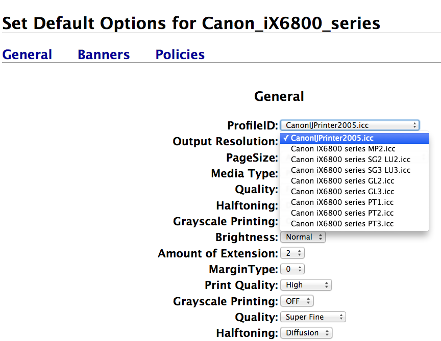

Update: I have been learning about CUPS and have learned how to enable the web interface for it. FINALLY there are options for setting the printer defaults! I am assuming that the dropdown menu below is for color management although there doesn't seem to be much by way of explanation. There is also no apparent means to turn color management OFF.
Possibly relevant: The CanonIJprinter2005 setting is what the printer was set to when I called up this menu. I have no idea what the difference is between all these different profiles.

All the profiles are for papers. What paper are you printing on?
