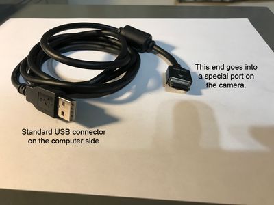

If it turns out that Canon offers a different USB data cable that is more compatible with newer computers, then I might have to go that route.  $$.  ☹️
For now, I want to try to get a usable driver that works on my 64 bit system.  I searched the drivers on my Canon CD, but they appear to be for 32 bit OS's (Win95 up to Win2000).  If an appropriate driver doesn't solve this problem, then I'll need a back-up plan (i.e. a different USB cable possibly).
At this point, everything is pointing to the camera.  It's either the computer driver for the camera or the data cable (or both).  I'll keep working on this and let everyone know what works.  🤞

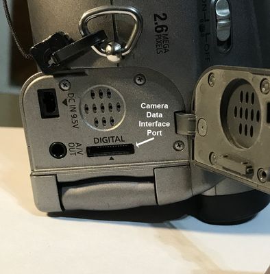

I don't think so.  Here's some pics to show what I've got.
The camera's data port doesn't look to be any kind of USB that I've ever seen before.  It looks totally custom.  Would you agree?

Just to follow up, the camera data connector appears to have 10-12 connection points.
I really don't think this is a USB type connection.

Yes, I agree. It's not the mini-B USB connector on the camera end.

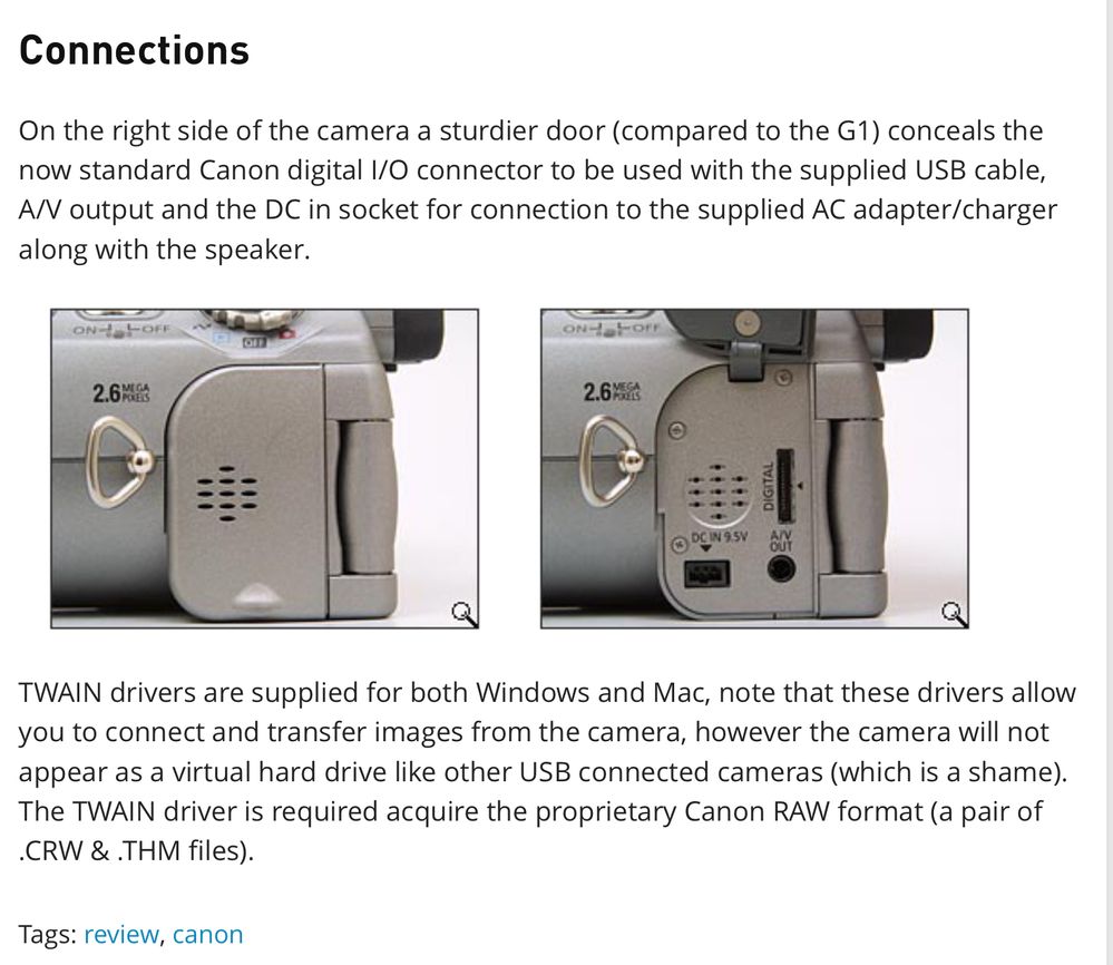

“ I was able to install ZoomBrowser EX from the CD on the Windows 10 computer without any installation problems and it seems to work OK until I try to connect to the camera.  The software hangs and has to be ended with the Task Manager.  When I start the Remote Capture software, it tries to connect and then brings up a dialog box saying it can't connect to the camera.
The old XP software is not compatible with the hardware in Windows 10 platforms.
Here is a link to a review of the camera from 2001.  It briefly describes the hardware.
https://www.dpreview.com/reviews/canonpro90/3
Here is a snapshot from the above web page.
