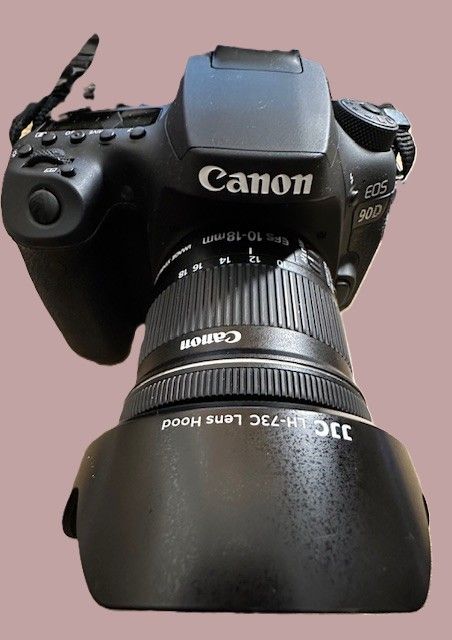

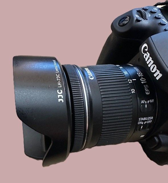

Here are some quick shots of my camera,  EF-S10-18 lens, and the JJC lens hood.  Perhaps the photos are a better way to describe some of what I was trying to describe in my initial response.  I have not observed any vignetting at 10mm using this setup.

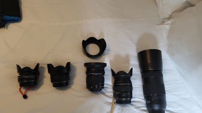

 I've just unpacked my case having arrived in Mallaig. From the right 70-300 zoom, EF 85mm,  EFS 10-18mm wide angle,  Nifty 50, and EFS 24 macro. Plus the wide angle also has a petal.  I think I've got some research to do. Any advice gratefully received.
Ramsden
Apologies phone photo reversed image - so from the left....
