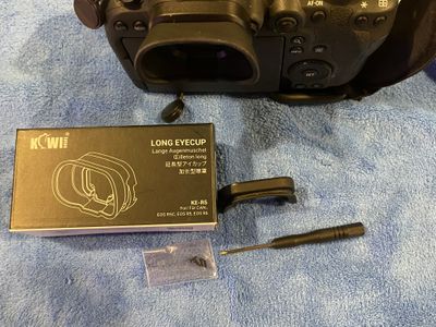

JeffXB
Enthusiast
Enthusiast
I just changed mine as well. And yeah, those screws are tight. The eye cup I bought included a tiny screwdriver and 4 extra screws (I can see how you could easily loose one!). Have to be careful not to cross thread them, making sure I had it perpendicular I turned the screw counter clockwise a little first until felt it “click”, then screwed it down until it was tight.
The photo shows the new one installed and the old one leaning against the box. Huge difference in both size and comfort. Much easier to look thru the view finder now.
