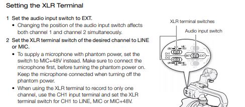

rs-eos
Does your external mic need phantom power?  If so, is the XLR terminal switch set to "MIC+48V"?
See page 75 in the User Guide for details if you haven't already done so.
Ricky
Camera: EOS 5D IV, EF 50mm f/1.2L, EF 135mm f/2L
Thank you but that is not the issue.  It’s as if I don’t have the upper XLR /handle attached.   Thought there may be a setting that I need to change so the camera would recognize the XLR.
