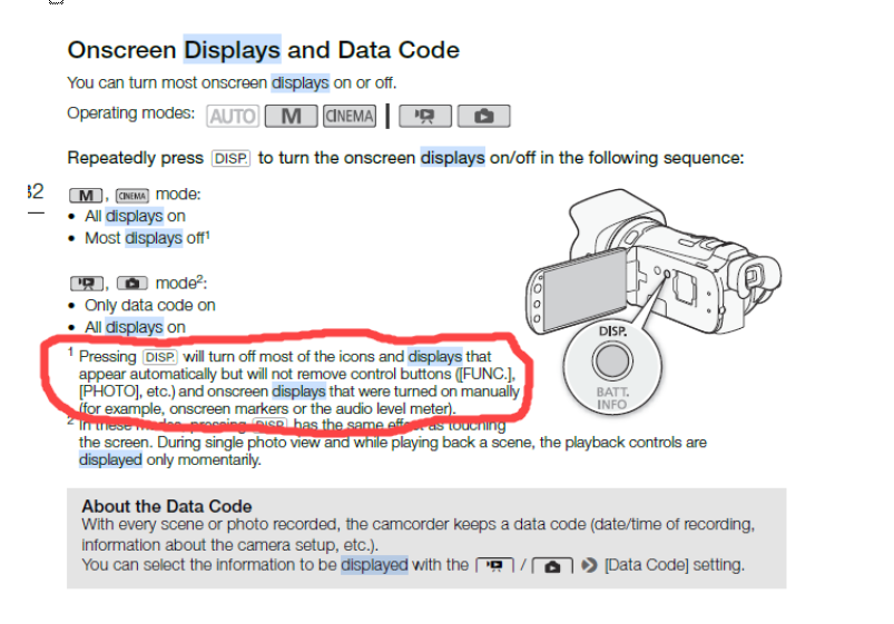

The problem is that there seems to be no way to remove "all" of the icons from the display when recording or, in this case, when streaming. He's getting this as a result:
The instruction manual makes it clear it can't be done:
Yet I thought I'd ask here anyway, in case there's a workaround or hack that might accomplish it that someone might be aware of.
