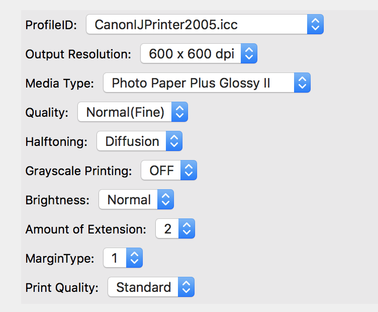

Here are some of the settings that I have in place right now.
Bought: ~ 3 months ago, it has always kind of been like this which is why I think it must be my settings
Printer: canon ix6820
Prevent Paper Abrasion is on
Drying time is Long
Paper is 80 lb Cover paper felt finish uncoated
US Letter default paper size, I'm printing borderless (edge to edge printing)
Canon colour matching
The other settings are screenshotted below.
My file is from Pages in Mac
I have the latest Macbook pro with latest iOS installed.
I find that the right side of the page has more bleed than the other side which is kind of strange.
I've tried doing the cleaning, i've tried doing the bottom plate cleaner and none of that worked. Let me know if you need any other information from me. I'm desperate! I don't know what to do to make the bleeding stop.
Thank you so much for your time in responding. I really appreciate it!Screen Shot 2018-05-09 at 8.10.56 PM.png
What software are you using to print. I have two Canon printers, neither the same as yours, but my print dialogues don’t look like yours.
The first line, profileid, does the drop down let you choose paper ICC profiles.

I used the canon driver from the instructions.
I'm printing in Pages, the Mac program.
these are the profile ids. I dno't see ICC. I read something about plate curves and dot compensation online becaus ei'm printing on uncoated paper. do you know if this is something I can adjust with the canon printer??
Try selecting the one in blue.
Are you using the paper type in the media line, or are you using non-Canon paper and they said to use that media type.
What file type type is the file? Pages native or is it exported as a file type.

the paper is not canon paper. So I just used the glossy one because i thought it would put less ink on the page. when I use the matte option, it gets worse.
I'm using Pages native, and haven't exported it.
I'll try with the diff selection profile id
